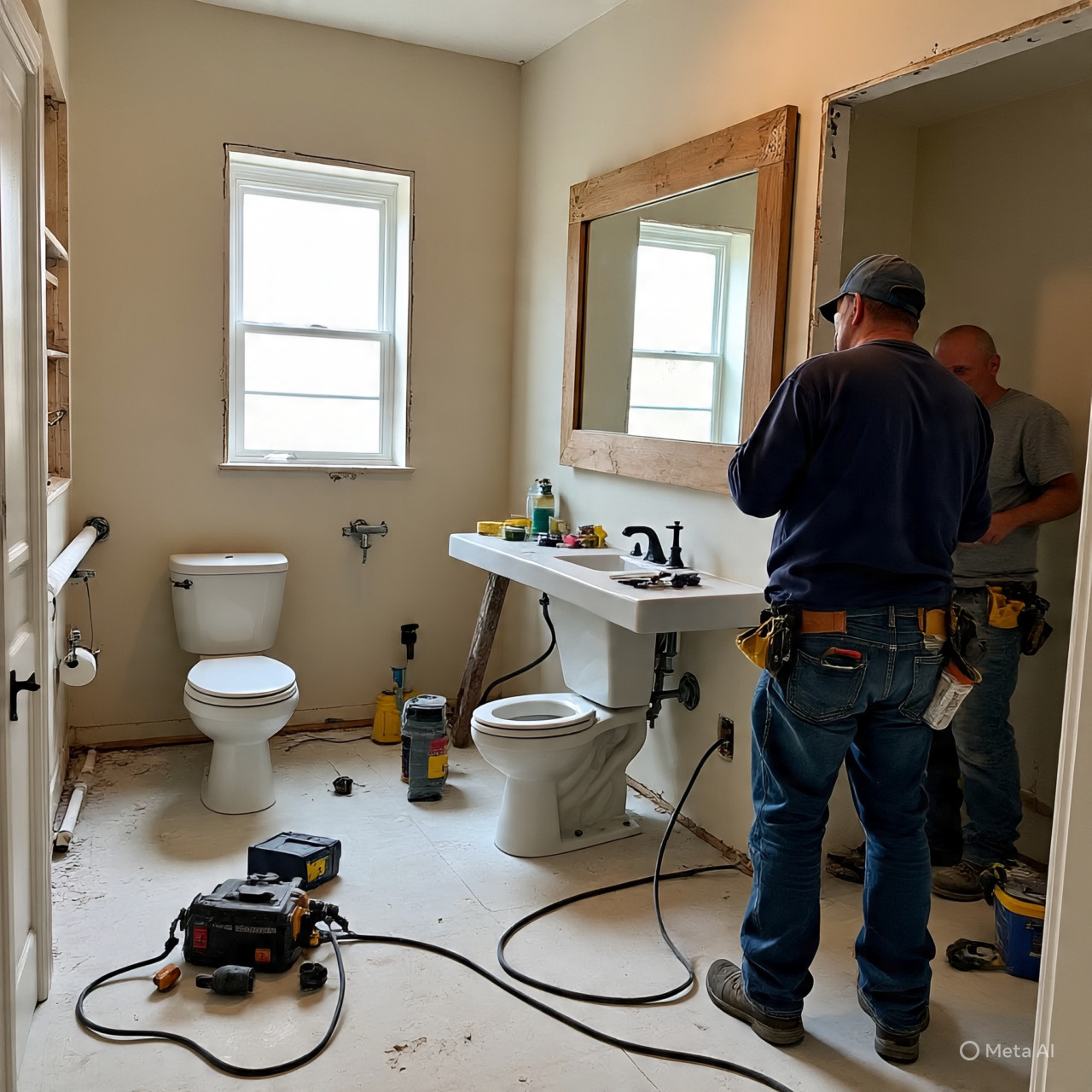

Bathroom Renovation Basics: Trade Knowledge That Prevents Costly Mistakes
Bathroom renovations are among the most detailed and technical projects in any home. While the finished space may look simple, tradespeople know that what happens behind the walls and under the floors is what truly determines success. Careful planning and the right tools are essential to avoid problems that can be expensive to fix later.
One of the first priorities on a bathroom renovation site is waterproofing. Professionals treat this as a non negotiable step. Before tiles are installed, membranes are applied to floors, shower walls, and around drains. Trades use wet film thickness gauges to ensure the membrane is applied evenly and at the correct depth. Skipping or rushing this process often leads to leaks, mold growth, and tile failure.
Modern plumbing tools have made bathroom upgrades more precise. Pipe crimping systems and press fit connections are commonly used because they reduce installation time and minimize the risk of leaks. Trades also use pressure testing tools to check water lines before closing up walls. This extra step may seem minor, but it prevents future damage and unnecessary rework.
Fixture selection also benefits from trade experience. Wall hung toilets and floating vanities are popular for their modern look and easy cleaning, but they require strong in wall frames and proper fixing. Installers often recommend quality mixer taps and shower valves with ceramic cartridges, as these last longer and perform better under daily use. Cheap fittings may save money upfront, but they tend to fail sooner.
Ventilation is another key element that professionals emphasize. Bathrooms generate high levels of moisture, and poor airflow can damage paint, cabinetry, and ceilings. Trades usually install exhaust fans with timers or humidity sensors to keep moisture under control even after the bathroom is no longer in use.
In conclusion, a bathroom renovation is not just about tiles and fixtures. Trade knowledge, specialized tools, and careful installation techniques ensure the space remains functional and problem free for years. When done correctly, a renovated bathroom adds comfort, hygiene, and long term value to the home.
