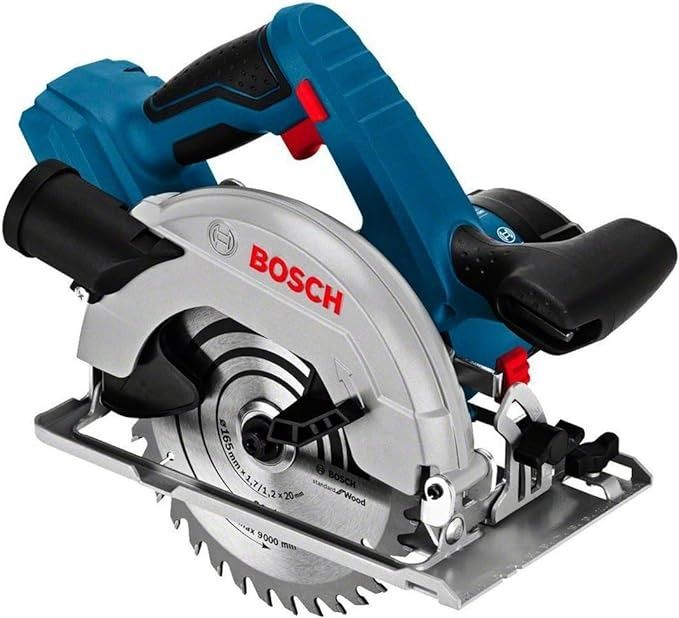

Hey, so when you’re using a circular saw, picking the right blade is super important. It really changes how well you cut, how fast you get it done, and how safe it all is. You can’t just use any blade for any job, you know? Different stuff needs blades made just for it.
Like, for wood, you’ve got a couple of choices. If you’re just hacking away at something and don’t care too much about the finish, a general wood blade with fewer teeth – maybe like 24 – is good. It cuts fast but can be a little rough. But if you’re working with nice wood, like for furniture or plywood, get a blade with more teeth, like 40 to 60. It takes longer, but your cuts will be way smoother and cleaner.
Then there’s metal. You can 't use a wood blade for metal! You need a special metal-cutting blade. These are usually made from carbide or some abrasive stuff, and they have a ton of teeth. That’s so they can handle how hard metal is without breaking or being dangerous.
For plastic or PVC pipe, you need something that won’t crack or chip the material. A fine-tooth blade maybe around 60 teeth works well here too.
And if you’re cutting tile, brick, or concrete, forget about regular blades. You have to use a diamond-tipped masonry blade. These blades are made to cut through really hard stuff without wearing out in five seconds.
So, yeah, it’s pretty simple: using the right blade for what you’re cutting makes a huge difference, it keeps you safer and make the work quicker and gives a good result. it will give a perfect finish you want, so always check your blade before you start cutting or doing renovation. Using the correct blade for your projects can reduce the likelihood of injuries, extend the life of your saw, and result in professional looking results. There’s nothing more satisfying than completing a project with clean lines and a job.
