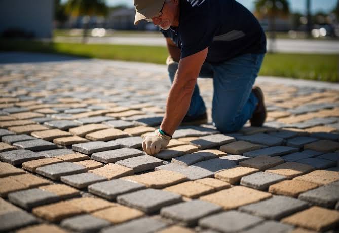

Choosing the Right Paver Materials for Durability and Load Performance
Paver selection directly impacts the lifespan and performance of hardscape projects. Not all pavers are designed to handle the same loads or environmental conditions. Choosing the wrong material leads to cracking, surface wear, and premature replacement.
Concrete pavers are widely used due to consistency and strength. They are manufactured to specific standards and perform well under pedestrian and vehicular loads. Proper thickness selection is essential. Thinner pavers are unsuitable for driveways.
Natural stone pavers offer durability and visual appeal. However, stone type matters. Some stones resist compression and weathering better than others. Softer stones may chip or flake under heavy use.
Clay brick pavers provide classic aesthetics and strong compressive strength. They perform well in walkways and patios but may not suit heavy vehicle traffic without proper thickness and base support. Load rating must guide material choice. Driveways require pavers designed for vehicular loads. Using patio grade materials in driveways results in surface failure regardless of base quality. Climate conditions influence performance. Freeze thaw resistance is critical in colder environments. Materials with high absorption rates are more prone to cracking. Low absorption materials perform better long term. Surface texture affects safety. Smooth surfaces can become slippery when wet. Textured pavers provide better traction, especially in sloped areas.
Color stability matters for appearance. Some materials fade under sunlight. Pigment quality and manufacturing processes affect long term color retention. Edge strength impacts durability. Weak edges chip during installation or use. Strong edge profiles resist damage and maintain alignment. Thickness consistency ensures even load distribution. Variations create pressure points that lead to cracking. Quality control during manufacturing matters. Joint compatibility should be considered. Some pavers work better with specific jointing materials. Proper pairing prevents washout and movement.
Maintenance requirements vary by material. Some pavers require sealing, while others perform well untreated. Long term care expectations should align with owner preferences. Replacement availability matters. Matching discontinued pavers later can be difficult. Standardized products simplify future repairs.
Installation technique must match material requirements. Even the best paver fails if installed incorrectly. Cost should be evaluated against lifespan. Cheaper materials often cost more over time due to repairs and replacement.
Conclusion: Selecting the right paver material ensures structural performance, safety, and durability. Matching material properties to load and environment protects hardscape investments.
