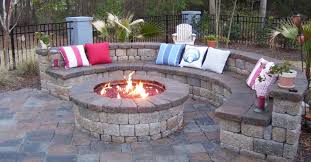

Creating a DIY Fire Pit in Your Backyard
There’s something timeless about gathering around a fire. Whether it’s for roasting marshmallows, sharing stories, or simply enjoying the flicker of flames on a cool evening, a fire pit brings warmth and charm to any backyard.
The best part?
You don’t need a contractor to make it happen, you can build one yourself with a few basic tools and materials.
Before you get started
  • Pick a safe spot in your yard, away from trees, fences, or anything flammable.
  • Once you’ve chosen the location, clear the area and mark the shape of your fire pit. A circle is classic, but you can also go for a square or rectangle if you prefer a modern touch.
Next
  • Dig a shallow hole about six to eight inches deep. This will help contain the fire and create a sturdy base.
  • Add a layer of gravel for drainage, then start stacking your bricks, stones, or concrete blocks around the perimeter.
  • Stagger the layers like you would when laying bricks, which helps keep the structure stable.
  • For extra durability, you can use heat-resistant mortar, though a dry stack of stones often looks more natural.
Once the walls are in place
  • Fill the center with more gravel or sand to create a level surface. If you’d like,
  • Add a metal fire ring inside the structure to protect the stones from direct heat and prolong the fire pit’s life.
  • After that, all that’s left is to gather some wood, pull up a few chairs, and enjoy your handiwork.
Building a DIY fire pit is a simple weekend project that adds instant character to your outdoor space. Not only does it create a cozy gathering spot for friends and family, but it also elevates your backyard into a welcoming retreat. With a little effort and creativity, you can enjoy the glow of a fire without ever leaving home.
