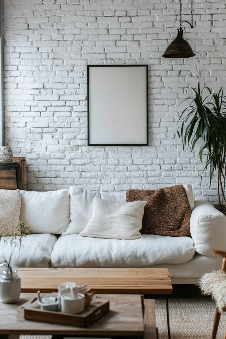

A faux brick wall brings industrial charm to your home.
Purchase brick veneer panels or thin bricks from a home store. Clean and prime the wall for adhesion. Apply construction adhesive and press panels or bricks into place, staggering joints for authenticity. Use spacers for consistent grout lines. Once set, apply grout with a piping bag, smoothing with a trowel, and wipe excess. Seal the surface for durability.
This weekend project costs $150-$250. The result is a textured, stylish wall perfect for a living room or bedroom. This DIY project mimics exposed brick without structural changes, offering a budget-friendly way to add character and warmth to your space. This activity could also prove to be a nice lovely weekend project, that you could do alone or with friends.
