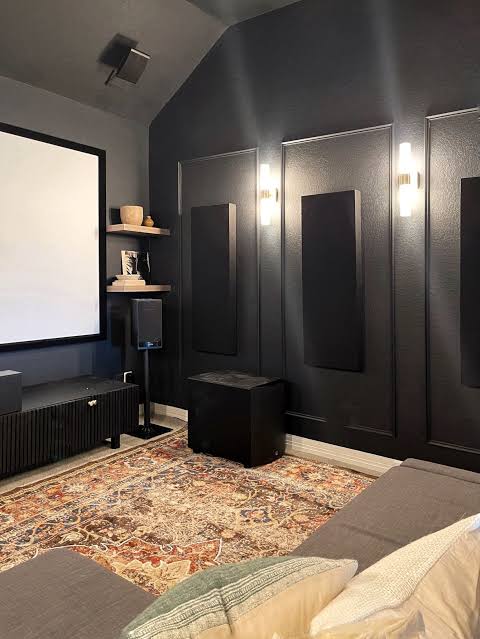

One of the most overlooked yet highly rewarding home improvement projects is the creation of acoustic wall panels. These panels are not only functional for sound control but also serve as attractive design features that can transform the atmosphere of a room. Tutorials that explain this process are increasingly popular because they combine practical sound solutions with creativity, allowing homeowners to achieve professional level results without the expense of hiring specialists. Acoustic wall panels are particularly useful in media rooms, offices, music spaces, or any area where sound quality and control are priorities.
The starting point in most tutorials is the choice of materials. Step by step instructions usually recommend medium density fiberboard or simple timber frames combined with acoustic insulation such as mineral wool or foam. Tutorials explain how to measure the wall space, cut the wood into accurate frame sizes, and secure the pieces with nails or screws. After the frame is built, the insulation is carefully fitted inside to form the sound absorbing core. Tutorials emphasize the importance of handling insulation materials with gloves and masks to ensure safety during the building process.
Covering the frame with fabric is the next critical step. Tutorials guide homeowners through stretching a breathable fabric across the surface, pulling it tightly, and stapling it neatly to the back of the frame. The choice of fabric is not only functional but also decorative. Many tutorials recommend using fire resistant materials in colors and patterns that complement the overall design of the room. For those seeking a modern effect, guides show how to integrate LED strip lighting behind the panels so that they glow softly when illuminated.
Mounting the panels to the wall is explained in detail. Tutorials provide several methods, including the use of Z clips, French cleats, or simple wall brackets. Each method is described with clear step by step instructions to ensure the panels hang securely and evenly. Accurate measurements are emphasized to avoid uneven alignment, which would affect both the appearance and the sound performance. Guides also cover spacing strategies, noting that panels should be placed where sound first reflects in the room or evenly along parallel walls to balance acoustics effectively.
Advanced tutorials go beyond the basics by teaching how to create panels of various shapes and thicknesses for different sound frequencies. Some guides show how to construct bass traps that are installed in the corners of rooms to absorb low frequency sounds. Others teach how to build diffuser panels that scatter sound instead of absorbing it, creating a natural and pleasing acoustic balance. These more complex projects allow homeowners to customize their sound environment according to their needs, whether for music production, home theater enjoyment, or simply reducing echoes in large spaces.
A major benefit highlighted in tutorials is the affordability of DIY panels compared to purchasing professional acoustic products. By sourcing materials locally and following instructions carefully, homeowners can achieve similar results at a fraction of the price. Many tutorials even provide cost breakdowns to show how budget friendly these projects can be. At the same time, they encourage investing extra effort in finishing touches such as sanding frames smoothly, painting the edges, and ensuring that fabrics are stretched without wrinkles for a polished appearance.
Safety considerations are also included in every tutorial. Builders are reminded to wear protective gear when cutting wood or handling insulation, to work in ventilated spaces, and to use tools responsibly. Tutorials make it clear that careful preparation and patience will produce results that are durable and effective.
The flexibility of acoustic wall panel tutorials is one of their strongest features. Beginners can start with simple square panels using basic tools, while advanced enthusiasts can experiment with larger projects, artistic patterns, or integrated lighting effects. Tutorials encourage creativity by showing how panels can serve not only as sound solutions but also as decorative wall art.
