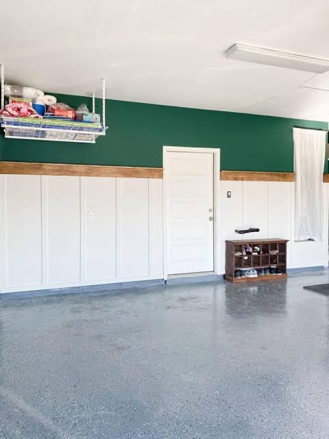

Board and batten walls are a timeless design element that add depth and interest to any room. They consist of vertical strips, or battens, placed over flat panels, creating a structured and elegant appearance.
To start, measure the wall and decide on the spacing between battens. This step is key because evenly spaced battens create a professional look. Mark the positions with a pencil and level.
Next, cut and attach baseboards if they are not already in place. Then install vertical battens, securing them with construction adhesive and finishing nails. Horizontal boards at the top and bottom frame the design. Wood filler should be used to cover nail holes, followed by light sanding for a smooth finish.
Painting is the final step. White is a popular choice, but darker shades such as navy or charcoal create dramatic effects. Semi-gloss paint works best for durability and easy cleaning.
This project requires basic tools like a saw, drill, level, and nail gun. It can usually be completed in a weekend.
Conclusion: a board and batten wall is a simple DIY project that delivers high-end style. It transforms plain walls into a focal point with structure and charm.
