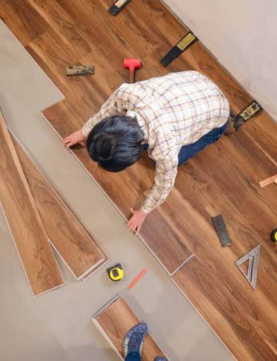

Installing new flooring can dramatically change the feel of a home. While many assume it’s a complicated task, modern materials like laminate and vinyl planks make DIY flooring accessible for beginners.
Start by measuring the room accurately. Purchase about 10% more flooring than calculated to allow for mistakes and trimming. Next, prepare the subfloor. It should be clean, dry, and level before installation. Remove old flooring, nails, or adhesives that could cause unevenness.
For click-lock laminate or vinyl planks, begin by laying an underlayment, which helps with moisture resistance and soundproofing. Place the first row of planks along the longest wall, leaving a small expansion gap (about 1/4 inch) around edges to allow natural movement.
As you continue, stagger the planks for a more natural appearance. A tapping block and rubber mallet will help lock pieces together tightly. For corners and edges, cut planks using a saw or utility knife.
Once the flooring is installed, add baseboards or trim to cover the expansion gaps. Cleaning the new floor with manufacturer-approved products will protect its finish and extend its life.
