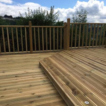

A garden deck extends living space outdoors, creating a perfect spot for relaxation, dining, or entertaining. While building one requires effort, it’s achievable for homeowners with basic carpentry skills. Careful planning ensures durability and aesthetic appeal.
Start by selecting a location. Choose level ground that receives good sunlight. Check local building codes or permits before beginning. Measure the area and design a layout, factoring in deck height, stairs, and railings.
Gather materials: pressure-treated lumber for framing, decking boards, screws, joist hangers, and concrete deck blocks or footings. Tools include a circular saw, drill, measuring tape, and level.
Begin by setting the foundation. Position deck blocks or dig holes for footings, spacing them evenly to support beams. Install beams securely, ensuring they are level. Attach joists perpendicular to beams using joist hangers, spacing them about 16 inches apart.
Lay decking boards across the joists, starting at one end. Leave small gaps between boards to allow for expansion and water drainage. Secure each board with screws rather than nails to ensure long-term stability. For edges, trim boards neatly for a clean finish.
If the deck is raised, install railings for safety. You can also add stairs leading down to the garden for convenience. Once construction is complete, sand any rough edges and apply a weather-resistant sealant or stain to protect the wood.
Furnish the deck with outdoor furniture, planters, or string lights to create a welcoming atmosphere.
Conclusion: Building a garden deck is a fulfilling DIY project that expands usable space and enhances outdoor living. With planning, sturdy construction, and finishing touches, homeowners can enjoy a beautiful deck that lasts for years.
