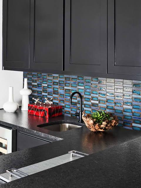

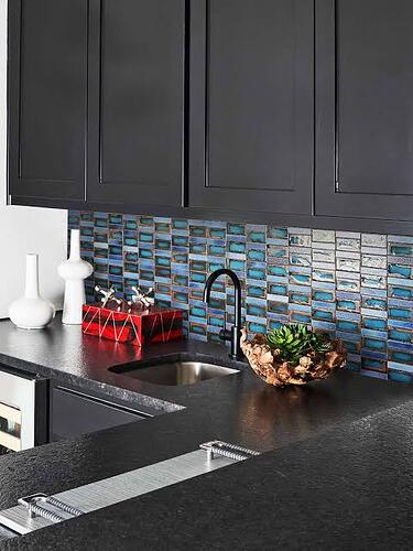

A backsplash is both a protective surface and a design statement. It shields walls from stains while adding style to the kitchen. Many homeowners assume installing one requires a contractor, but peel-and-stick tiles or simple ceramic options make this a manageable DIY project.
Begin by measuring the backsplash area. Calculate the square footage and purchase about 10% extra material to account for mistakes or trimming. Popular choices include ceramic tiles, glass, stone, or peel-and-stick vinyl. Peel-and-stick is easiest for beginners, while ceramic and glass provide a more permanent finish.
Prepare the wall by cleaning it thoroughly to remove grease and dirt. If using ceramic, apply a thin layer of tile adhesive with a notched trowel. For peel-and-stick tiles, ensure the surface is smooth and dry before starting.
Mark a level line at the bottom of the area to guide your first row. Begin at the center and work outward for a balanced look. Press each tile firmly into place, using spacers if working with ceramic to maintain even grout lines. For outlets and corners, cut tiles with a utility knife (for vinyl) or a tile cutter (for ceramic and glass).
Once tiles are in place, ceramic and glass backsplashes require grouting. Apply grout with a rubber float, pressing it into spaces between tiles. Wipe off excess with a damp sponge and allow it to cure for 24 hours. Peel-and-stick tiles skip this step, offering instant results.
Finish the edges with trim pieces or caulk to give the backsplash a polished look. Step back and admire how a simple wall covering transforms the entire kitchen.
Conclusion: Installing a backsplash is a rewarding DIY project that blends function with design. Whether using peel-and-stick or traditional tiles, homeowners can achieve a professional look while protecting walls from everyday kitchen messes.
