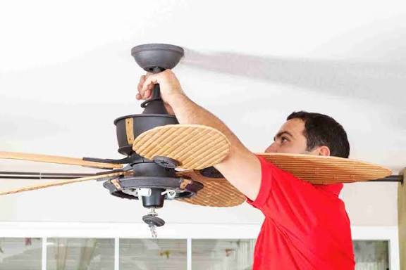

Ceiling fans are a great way to improve air circulation while adding style to a room. They can help lower cooling costs in summer and keep warm air circulating in winter. Many homeowners assume installation is complicated, but with preparation and attention to detail, it’s a manageable DIY project.
The first step is safety. Before touching any wiring, shut off power at the circuit breaker. Remove the existing light fixture or fan, disconnecting wires carefully. Check the electrical box ceiling fans are heavier than lights, so the box must be rated for fan support. If not, replace it with a fan-rated one to avoid accidents.
Next, assemble the fan parts according to the manufacturer’s instructions, leaving blades detached for now. Attach the mounting bracket to the ceiling box, then lift the fan motor and secure it in place. Connect the wiring: black to black (hot), white to white (neutral), and green or copper to the ground wire. Twist connections tightly with wire nuts and tuck them neatly into the box.
Once the wiring is complete, attach the fan blades and light kit, if included. Restore power at the breaker and test the fan on all speeds to ensure smooth operation. Adjust the direction switch for seasonal use: counterclockwise in summer for cooling and clockwise in winter to circulate warm air.
Conclusion: Installing a ceiling fan requires patience and caution with wiring, but it’s well within the ability of most homeowners. Beyond comfort, this upgrade helps reduce energy costs and enhances the overall look of a room.
