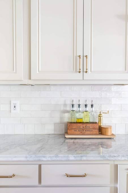

Renovating your kitchen can be both rewarding and cost-effective when you tackle projects yourself. One of the most popular DIY renovations in 2025 is installing a new backsplash, which instantly modernizes the space and adds a personal touch.
Before starting, it is important to plan carefully. Measure your backsplash area accurately and select the materials you want to use, whether ceramic tiles, glass panels, or peel-and-stick options. Tools commonly needed include a level, measuring tape, tile spacers, adhesive, grout, and a tile cutter.
The first step is preparing the wall. Clean the surface thoroughly and remove any old adhesive or paint residue. Apply a primer if needed, especially for porous surfaces. Next, mark the layout using a level to ensure straight rows and even spacing. Planning the placement beforehand avoids uneven lines and reduces waste.
Applying the adhesive is the next stage. Spread it evenly with a notched trowel, covering only a small section at a time to prevent it from drying before the tiles are placed. Begin from the center or a prominent focal point and work outward, using spacers to maintain consistent gaps.
Once the tiles are in place, allow the adhesive to set according to the manufacturer’s instructions. Grouting follows, filling the spaces between tiles for a finished look. Wipe off excess grout with a damp sponge and clean the surface thoroughly. After drying, sealing the grout can help prevent stains and maintain durability.
DIY backsplash installation allows homeowners to transform their kitchens with minimal cost while gaining a sense of accomplishment. It also encourages creativity, as you can experiment with colors, patterns, and textures to suit your style.
DIY kitchen backsplash tutorials provide homeowners with the knowledge and confidence to take on manageable renovation projects. Following careful planning, preparation, and step-by-step execution can result in a professional-looking upgrade. Beyond cost savings, the satisfaction of completing a renovation yourself makes the finished space uniquely personal and rewarding.
