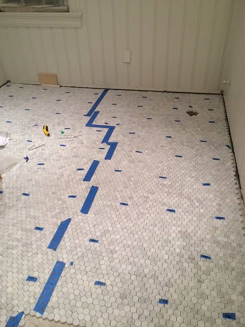

Before laying a single tile, meticulous planning is key. Measure your space twice and create a layout plan. Use a chalk line or laser level to mark a straight starting point—never rely on walls or floors, which are often uneven. Dry-lay tiles to visualize the pattern and ensure cuts are minimized at edges. According to a 2024 DIY Network guide, 80% of tiling mishaps stem from poor planning. Invest in a quality tile cutter or wet saw for precise cuts, and always buy 10-15% extra tiles for mistakes or future repairs.

Uneven spacing screams amateur. Tile spacers (1/8-inch for floors, 1/16-inch for walls) ensure consistent grout lines. For a foolproof finish, invest in tile leveling systems, which clip tiles together to prevent lippage (uneven edges). A 2025 Home Depot guide notes that leveling systems can cut alignment errors by 50%. Check each tile with a spirit level as you go, adjusting before the adhesive sets.
