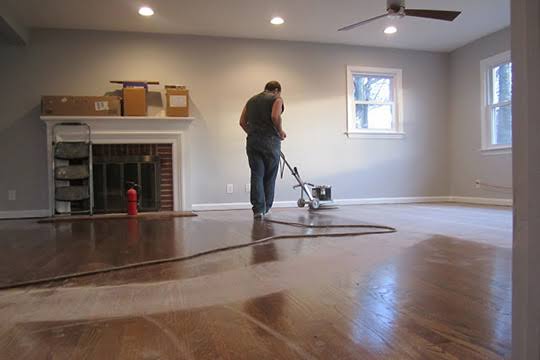

Hardwood floors add timeless elegance to any home, but years of foot traffic can cause scratches, dullness, and stains. Refinishing them restores their beauty and extends their lifespan. Though labor-intensive, this project is doable for determined DIYers with basic tools and patience.
Start by clearing the room completely. Remove furniture, rugs, and baseboards if possible. Inspect the floor for nails or staples sticking out, and hammer them flush with the surface.
Rent a drum sander or orbital floor sander from a home improvement store. Begin sanding with coarse-grit sandpaper to remove old finish and scratches, then gradually switch to finer grits for a smooth finish. Work in even passes, moving with the wood grain to avoid gouges. For edges and corners, use a handheld sander.
After sanding, vacuum thoroughly and wipe the floor with a tack cloth to remove dust. Apply a wood stain if you wish to change the color, using a brush or cloth for even coverage. Allow it to dry completely before moving to the next step.
Seal the floor with polyurethane or a water-based finish. Use a lambswool applicator or paint pad, working in long strokes with the grain. Apply two to three coats, allowing proper drying time between each.
Once dry, reinstall baseboards and return furniture carefully, placing pads under legs to prevent scratches. The result will be floors that look brand new and shine for years to come.
Conclusion: Refinishing hardwood floors is a demanding yet worthwhile DIY project. It requires time, effort, and proper tools, but the payoff is a rejuvenated space with restored warmth and character.
