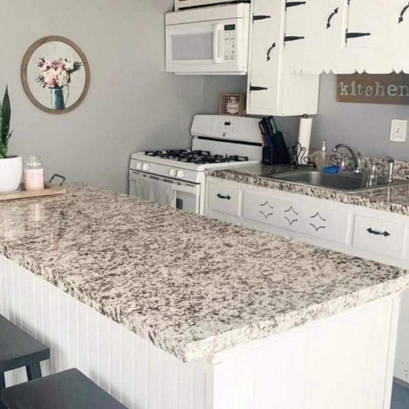

Material: Adhesive-backed vinyl, often printed to resemble marble, granite, wood, or solid colors.
Application: Installed directly over existing countertop surfaces, smoothed out to eliminate bubbles.
Target Market: Renters, homeowners on a budget, or individuals seeking temporary design updates.

- Installation Best Practices
Thoroughly clean and degrease the existing countertop before application.
Select thicker vinyl (≈4 mm) for more durability and better coverage of imperfections.
Use a squeegee to smooth air bubbles.
Seal edges with caulk, especially around sinks and high-moisture areas.
Avoid direct heat and always use cutting boards and trivets.
