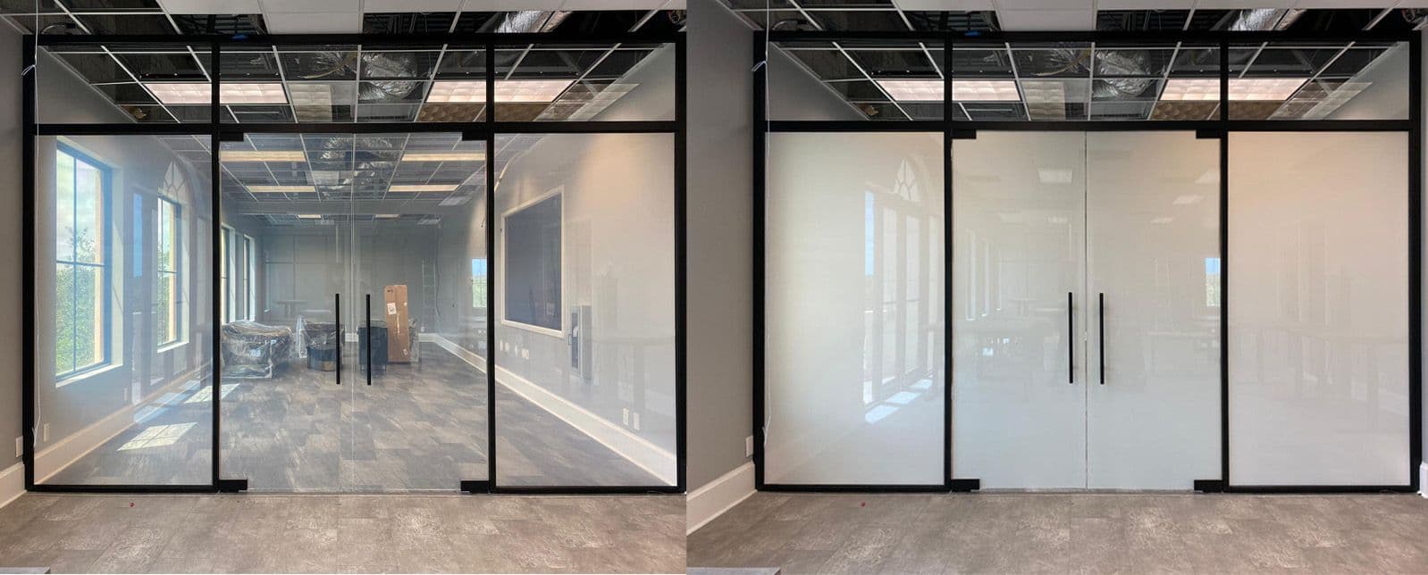

What Is It?
Electrochromic smart glass is a new type of window glass that changes tint based on light, heat, or user control.
It helps reduce glare, block heat, and protect privacy â all without blinds or curtains.
This isnât science fiction â itâs real tech, just not yet common in most homes.

How Does It Work?
Smart glass contains a thin layer of electrochromic materials (often tungsten oxide) between panes of glass.
When voltage is applied, it changes how much light or heat passes through.
It can be:
- Manually controlled via switch or app
- Automatically triggered by sunlight or room temperature
