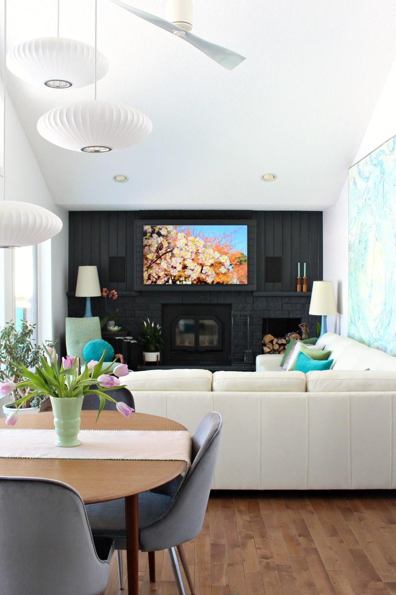

To mount a TV above a fireplace, ensure safety and aesthetics. Check the fireplace’s heat output; use a thermometer to confirm the wall stays below 100°F during use. Install a deep mantel to deflect heat. Secure a tilting TV mount to studs or brick using appropriate anchors, like Tapcon screws. Hide cables with in-wall conduit or covers. Consult a professional for complex setups.
- Conclusion: With careful planning, mounting a TV above a fireplace creates a sleek, functional focal point safely.
