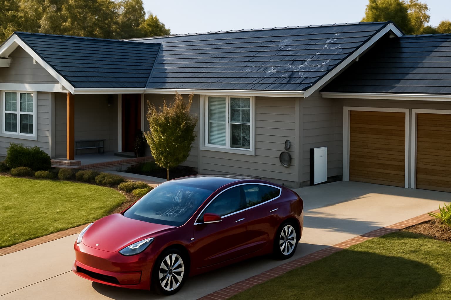

Hail claims: how often do Class-4 roofs experience cracked tiles without leaks; what are insurer repair vs replacement …
Hail claims: how often do Class-4 roofs experience cracked tiles without leaks; what are insurer repair vs replacement thresholds and typical homeowner out-of-pocket costs?
Would firstt like to clarify that hail damage stretches across all roof types, not just solar. If you think damage would only exist here - you are truly mistaken.
I fixed one after golf-ball hail two years ago. We found 70 cracked tiles but a dry attic! its underlayment did the waterproofing.
Any crack that crossed the water course got the tile replaced; tiny corner chips below the headlap were cosmetic.
Insurance paid per-tile on one house and slope replacement on another when matching tile wasn’t available.
Homeowners paid the hail deductible and any code upgrades without Ordinance & Law coverage.
My advice: photo everything, map counts by slope, inspect the underlayment, and keep a few spares for next time.
