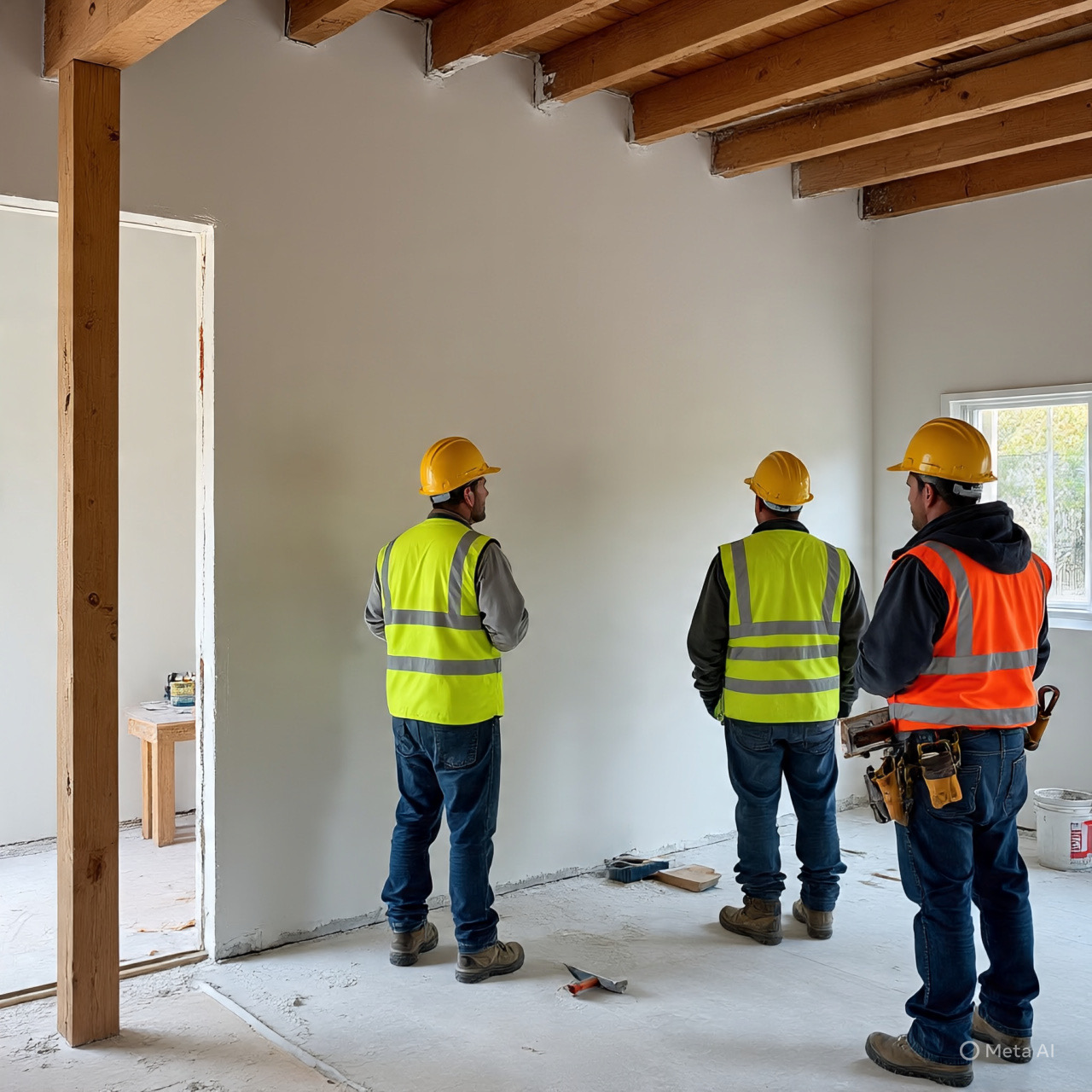

Home Renovation in Trade Talk: Plastering and Screeding Done the Right Way
In renovation trade talk, plastering is where patience and skill really show. A good plasterer leaves walls so smooth they barely need sanding. A bad one leaves waves, trowel marks, and endless snag lists. On site, people say, “Paint only shows what plaster hides.”
The job starts with background prep. Loose material is knocked off, dust is brushed away, and bonding agents are applied where needed. Old walls often need bonding coat before skim. Trades know that plaster won’t stick to shiny or dusty surfaces, no matter how good the mix is.
Mixing plaster is an art in itself. In trade terms, the mix must be “just right”—not too thick, not too runny. Too wet and it sags; too dry and it drags. Professionals mix in clean buckets with clean water because even a bit of old plaster can ruin the set time.
Application is done in stages. The first coat is laid on firm to flatten the wall. The second coat builds up smoothness. Timing is everything—troweling too early pulls plaster, too late and it won’t close. Experienced plasterers read the wall, not the clock.
For floors, screeding comes into play. Trades use sand-and-cement or self-levelling compounds depending on the finish. Screeds must be level, compacted, and allowed proper curing time. Rushing this stage causes cracked tiles or uneven floors later.
Edges and corners separate clean work from rushed jobs. Beads are fixed straight, reveals are sharp, and joints are blended seamlessly. In trade talk, neat corners mean pride in workmanship.
In renovation trade talk, good plastering and screeding are the foundation of a quality finish. When walls are flat and floors are level, every other trade works easier. It’s quiet work, but it carries the whole renovation.
