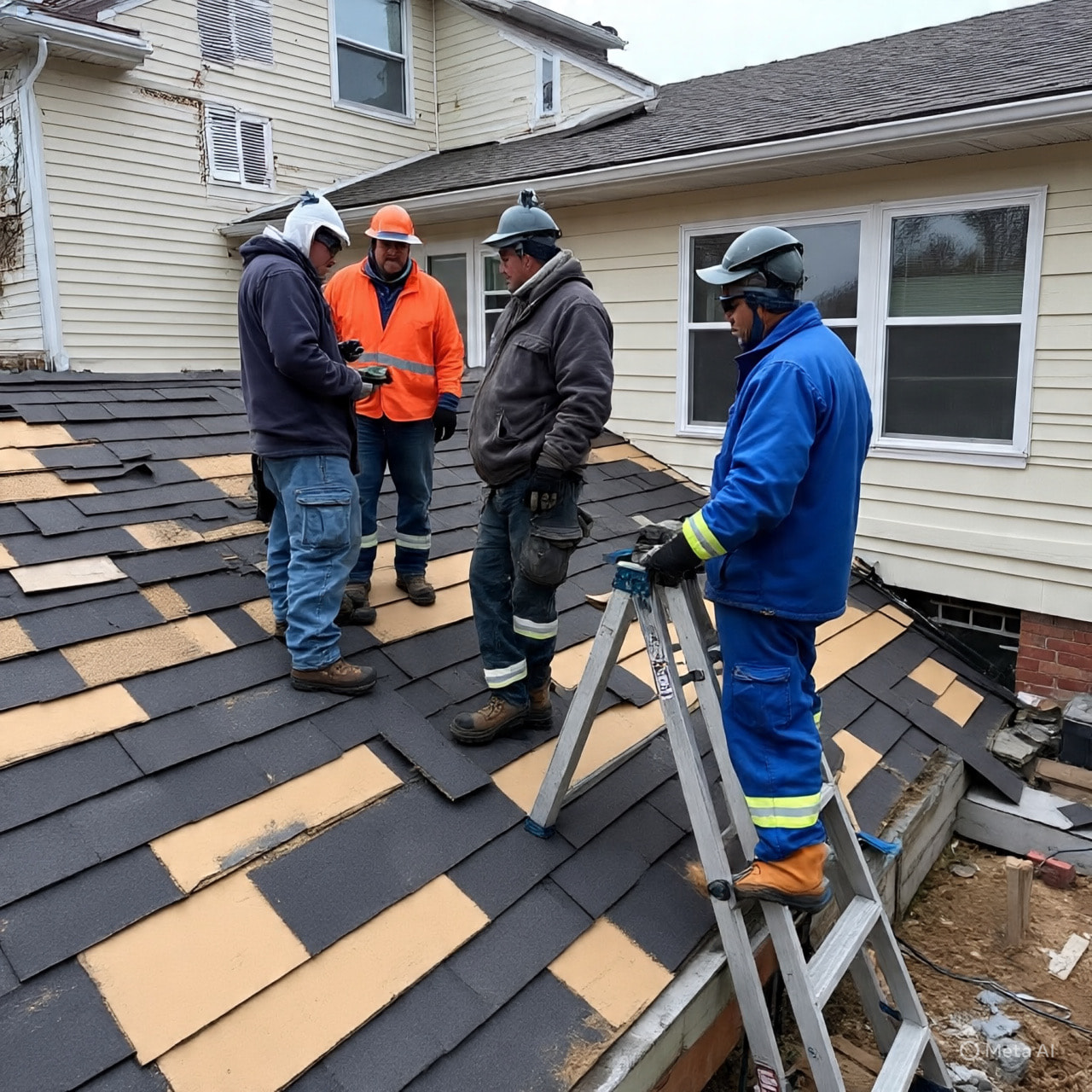

Home Renovation in Trade Talk: Roofing Work That Protects Everything Below
In renovation trade talk, roofing is never cosmetic—it’s protection. A bad roof doesn’t just leak; it destroys ceilings, walls, wiring, and finishes. Trades know that if the roof isn’t right, the rest of the renovation is at risk.
The first step is inspection. Roofers check timbers, rafters, and battens for rot or sagging. In older homes, termite damage or water rot is common. Any weak timber gets replaced before new coverings go on. In trade terms, “Don’t cover bad bones.”
Roof covering choice depends on climate and structure. Tiles, metal sheets, or shingles all need correct fixing methods. Metal roofing requires proper overlap and expansion allowance to prevent noise and buckling. Tile roofs demand even batten spacing and secure fixing to handle wind uplift.
Flashing is where many roofs fail. Around chimneys, valleys, and roof junctions, flashing must be correctly dressed and sealed. Trades often say, “Most leaks are flashing leaks.” Cheap sealants don’t last; proper metal flashing does.
Gutters and downpipes are part of the roofing system, not an afterthought. Correct fall, secure brackets, and adequate capacity prevent water backing up under the roof edge. Blocked or undersized gutters can cause damp walls and foundation issues.
Ventilation also matters. Roof spaces need airflow to reduce heat build-up and condensation. Trades install vents or breathable membranes to protect insulation and timber over time. Without ventilation, even a new roof can fail early.
Final checks include water testing and visual inspection. A good roofer leaves no loose fixings, no sharp edges, and no debris. In trade talk, a clean roof is a professional roof.
In renovation trade talk, roofing is about durability, detailing, and discipline. When done correctly, it quietly protects every trade beneath it. A solid roof is the true insurance policy of a renovated home.
