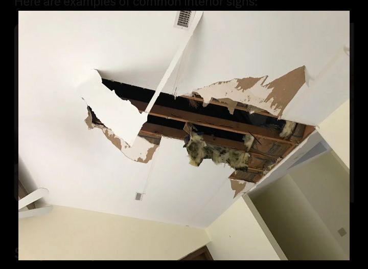

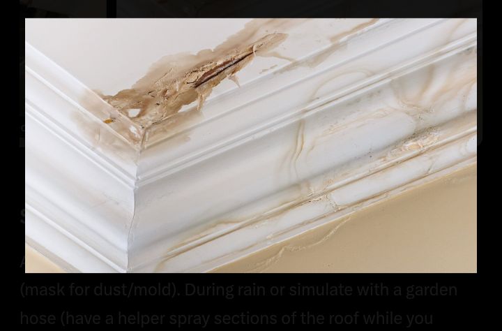

Start inside your home during or right after rain to spot active leaks. Look for:
- Water stains or discoloration on ceilings, walls, or around light fixtures (brown, yellow, or copper-colored rings).
- Dripping water, bubbling paint, or peeling wallpaper.
- Mold growth, musty odors, or warped drywall/wood.
- Damp spots in the attic insulation or on rafters.
If you see these, trace upward the entry point on the roof is often higher than where water appears inside due to gravity and sloping.

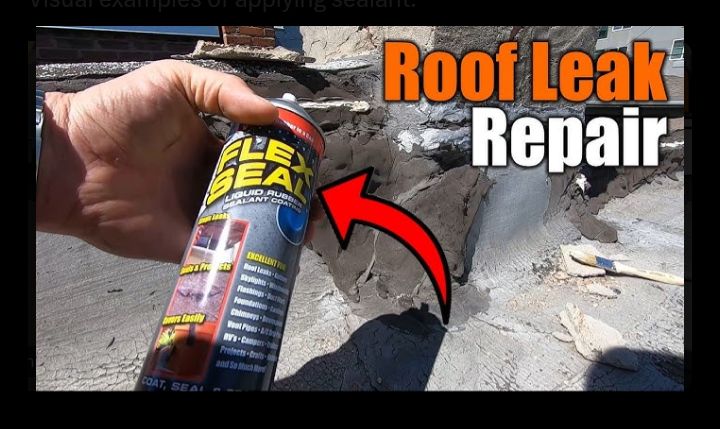

- Roofing cement/sealant (e.g., Henry Wet Patch or Flex Seal for wet surfaces).

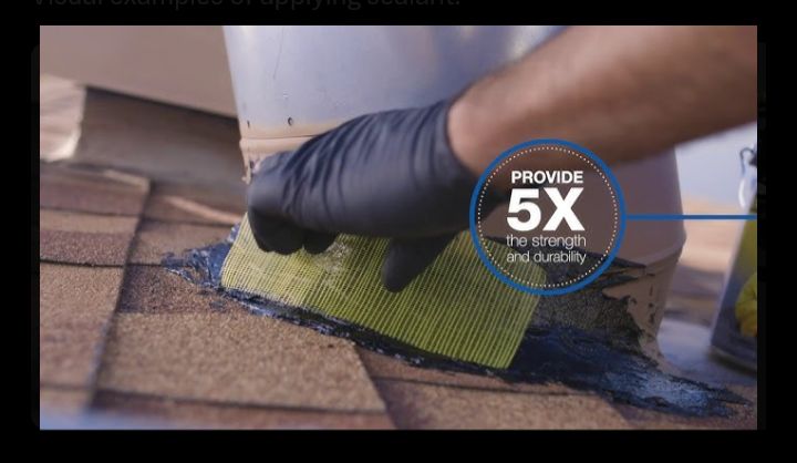

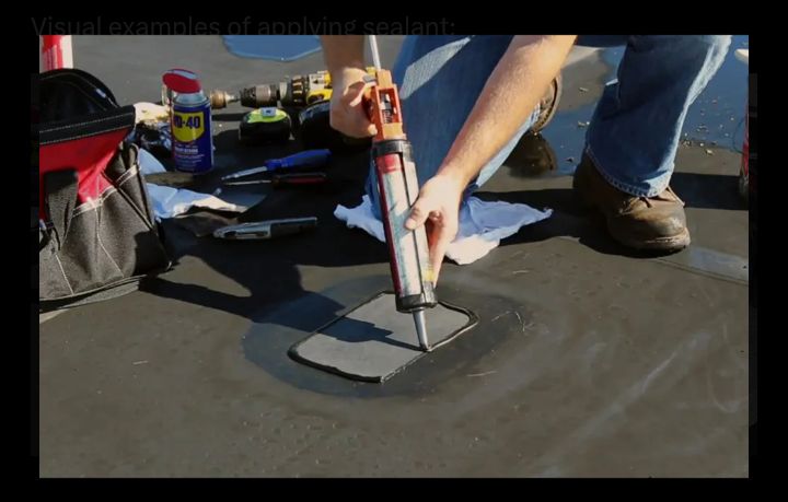

Step 5: Seal the Leak
- For small cracks/holes: Apply a thick layer of roofing cement with a putty knife, extending 2-3 inches beyond the damage. Press in firmly.
- For damaged shingles: Lift the shingle above the leak, apply cement underneath, nail down if loose (use roofing nails), then seal edges with more cement.
- For flashing/gaps: Clean with wire brush, apply sealant generously into joints, and cover with patch material if needed.
- For larger areas: Cut a patch to size, apply cement to the back, press onto the leak, and seal edges. Weigh down with bricks while drying (follow product cure time, often 24 hours).
Visual examples of applying sealant:
