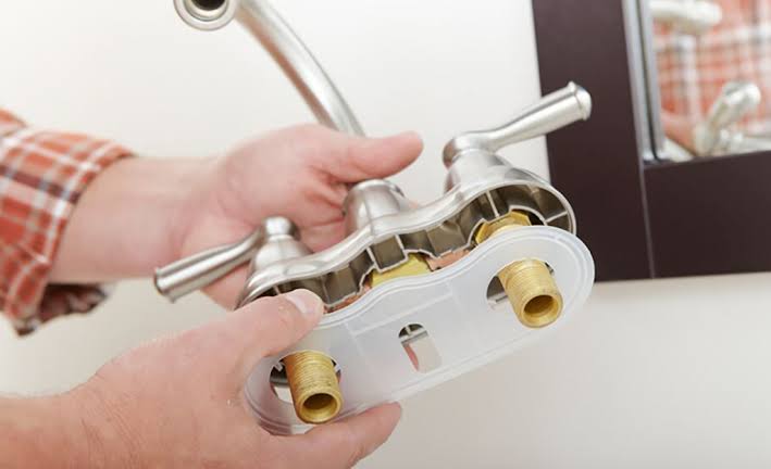

How to Install a New Bathroom Faucet
Installing a new faucet can improve both the look and function of your bathroom.
*Steps:*
1. *Turn off water supply* — shut valves under the sink.
2. *Remove old faucet* — loosen nuts and disconnect water lines.
3. *Clean sink surface* — remove old putty or sealant.
4. *Place new faucet* — fit it into the sink holes.
5. *Secure faucet* — tighten mounting nuts from underneath.
6. *Connect water supply lines* — attach hot and cold water hoses.
7. *Turn on water and test* — check for leaks and proper flow.
This small upgrade can make your bathroom feel fresh and modern.
