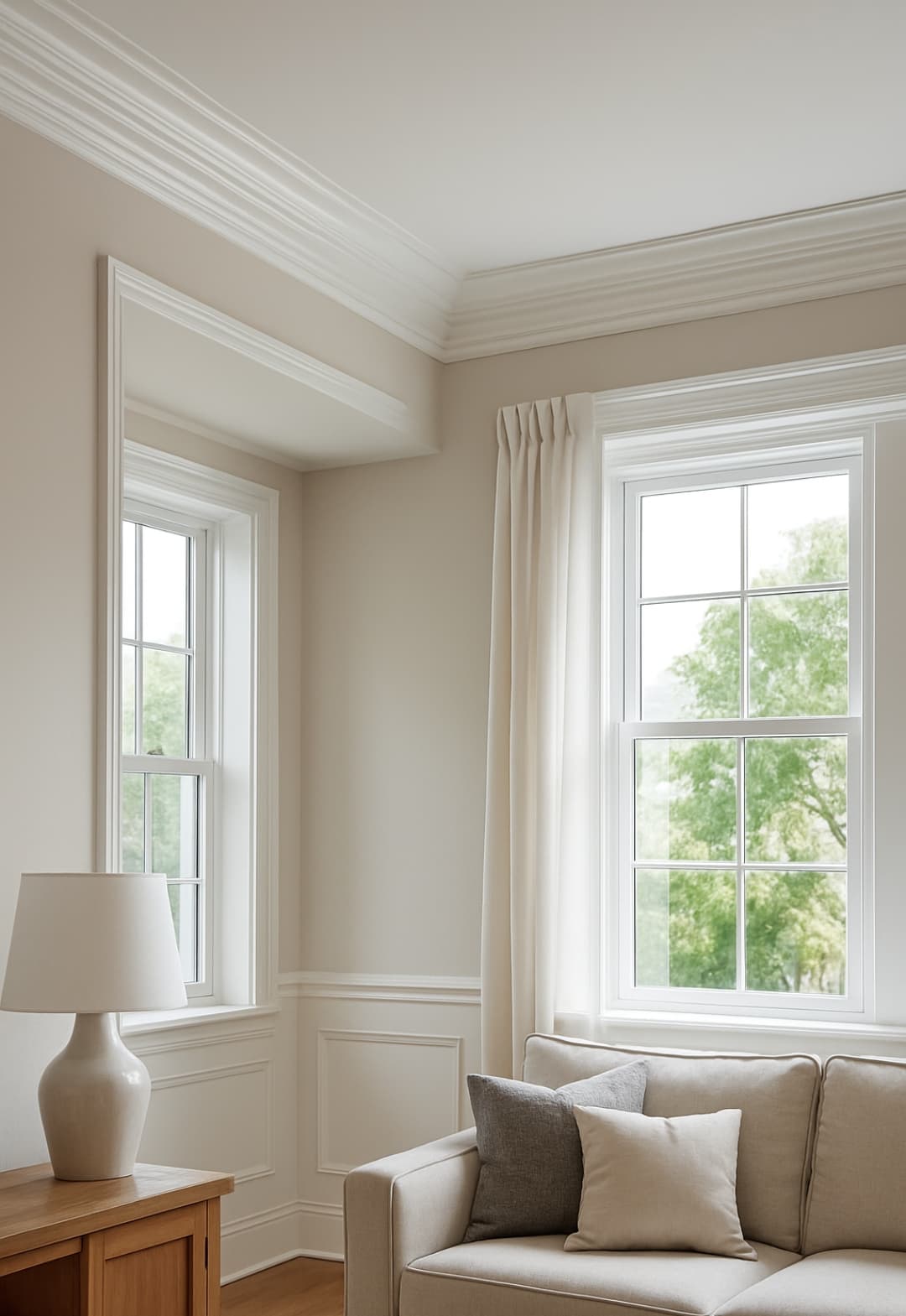

How to Install Crown Molding Like a Pro
Crown molding is a simple DIY project that can instantly give any room a polished, high-end look. With the right tools and a bit of patience, you can handle it yourself.
Materials needed
Measuring tape & level
Miter saw (or miter box)
Nail gun or hammer with finishing nails
Caulk or wood filler
Paint or stain
Step 1: Measure & Plan
Measure the room’s perimeter and buy a little extra molding to allow for mistakes. Choose a style that matches your décor.
Step 2: Cut & Fit
Use a miter saw set at 45° for corners. For a seamless look, cope cut inside corners. Test cuts on scrap wood first.
Step 3: Install & Secure
Nail molding into studs, starting at the corners. Use a level to keep everything straight.
Step 4: Finish the Look
Fill gaps and nail holes with caulk or wood filler, sand smooth, then paint or stain.
Crown molding may seem tricky, but it’s a manageable DIY that instantly adds charm and value to your home. With accurate cuts and clean finishing, you’ll have a pro-level result in no time.
