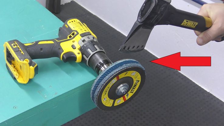

:hammer_and_pick: Getting Sharp
Hand Tools Like Chisels and Knives:
Use sharpening stones or guides to keep a steady angle—usually around 25–30 degrees. This keeps the edges just right for clean cuts.
Saws and Blades:
For handsaws, a file and saw set tool can bring those teeth back to life. For circular saw blades, it’s often best to replace them or get them professionally sharpened to make sure they cut straight.
Drill Bits:
A drill bit sharpener or bench grinder can get your drill bits back in shape. Just make sure to keep the angle right so they drill just like they should.
Garden Tools:
If you use garden tools, a metal file or sharpening stone works well. Then, add a coat of oil to keep rust away.
