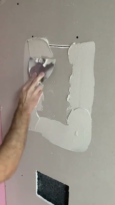

Stick the Patch In - Small holes: Use those sticky mesh patches.
- Medium/Large holes: Screw the patch into the wood or studs.
Tape It Up - Put drywall tape around the edges of the patch.
- Press it down good.
Mud Time – First Coat - Use your knife to spread a thin layer of mud over the patch and tape.
- Make the edges smooth.
- Let it dry. Usually, wait a day if it’s a thick coat.
Sand and Repeat - Sand the first coat a bit to get rid of bumps.
- Put on another coat of mud, making it wider than the first.
- Let it dry, then sand again.
- Do a third coat if you need it to make it super smooth.
