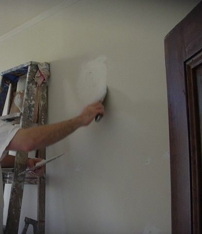

  1. Fix Any Damage
Even tiny dents or holes will show through the paint.
Fill holes with spackle or joint compound.
Sand it smooth after it dries.
If needed, swap out any beat up drywall.
