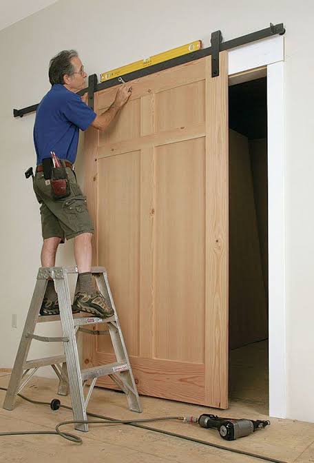

Start by choosing the door itself. You can purchase a pre-made barn door from a store, or you can build one from scratch using pine or reclaimed wood. Building one allows for more customization in size, finish, and design. Regardless of your choice, the door must be wider than the opening by at least two inches on each side to provide proper coverage.
Next comes the track system. A barn door kit typically includes a rail, rollers, stops, and brackets. Install a header board above the doorway to support the weight of the door and distribute pressure evenly across the wall studs. Mount the track onto the header, making sure it is level. This step is crucial because a slight tilt will cause the door to slide on its own.
Attach the rollers to the top of the door, then lift the door onto the track. Add the provided stops at each end so the door does not slide off. A floor guide is also important, as it keeps the door from swinging and ensures smooth movement. Once installed, test the door several times to confirm it glides quietly and securely.
