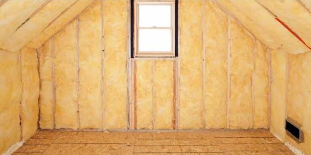

Attic insulation is often the most impactful upgrade. Heat naturally rises, and poorly insulated attics allow warm air to escape during winter or hot air to enter during summer. Adding insulation to the attic floor or under the roof deck improves temperature regulation throughout the home. Common materials for attic insulation include fiberglass batts, blown-in cellulose, and spray foam, each offering specific benefits in terms of R-value, coverage, and air sealing.
