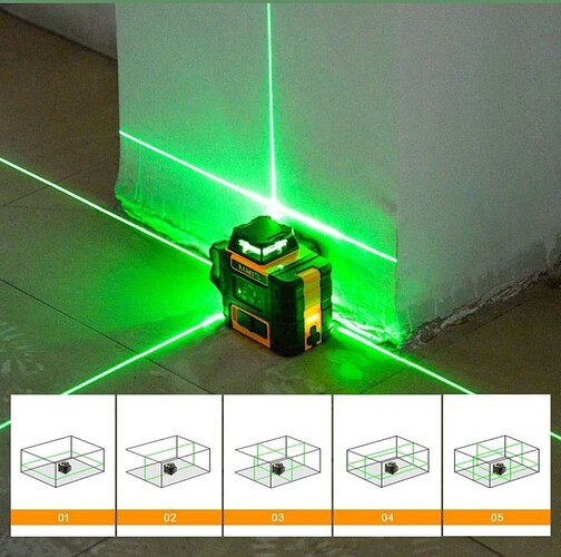

A laser level is one of the most precise tools for ensuring accuracy in any construction or renovation project. Unlike traditional levels, which rely on bubble vials, a laser level projects a straight line across a wall, floor, or ceiling. This makes it perfect for aligning shelves, tiles, cabinets, or picture frames, and it saves significant time compared to manual measuring.
To use a laser level effectively, place it on a stable surface or mount it on a tripod. Switch it on and allow it to self-level if it has that feature. Mark the projected line with a pencil or painter’s tape, and use it as a guide for your installation. Make sure the device is positioned at a consistent height and that there are no obstacles blocking the laser. For long projects, check periodically to ensure the laser has not shifted.
A quirky tip is to use the laser to mark multiple points on walls and floors simultaneously, creating a grid for complex tiling or framing projects. This reduces mistakes, keeps everything aligned, and ensures a polished finish. Laser levels are particularly helpful for large rooms, long hallways, or projects where even a small misalignment can become very noticeable.
