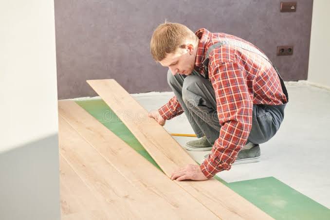

Laminate flooring is popular because it is durable, stylish, and easier to install than hardwood. A DIY laminate project can transform any room in just a few days.
Begin by clearing the room and ensuring the subfloor is clean and level. Lay down underlayment, which cushions the floor and reduces noise. Start in one corner and connect the planks using the manufacturer’s locking system. Use spacers to leave room along walls for expansion.
Cut planks as needed with a saw, ensuring tight joints throughout. Once complete, reinstall baseboards to cover gaps and give the floor a seamless look. Laminate comes in wood, stone, and tile patterns, making it versatile for different styles.
Conclusion: Installing laminate flooring yourself saves money and gives a fresh, modern look. With preparation and patience, even first-time DIYers can achieve professional results.
