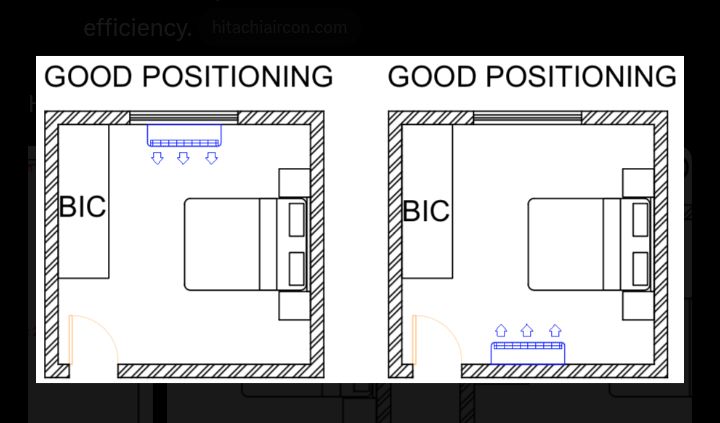

‎ Indoor Unit (for Split or Wall-Mounted ACs):

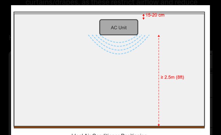

‎- Height and Position: Install the unit high on the wall, ideally in the top third of the wall, about 8-9 feet (2.5 meters) from the floor and 6-8 inches (15-20 cm) from the ceiling. This allows cool air to sink and distribute evenly across the room. Avoid low placements, as they can lead to uneven cooling and higher energy use.
‎- Room Location: Choose a central wall in the room, away from direct sunlight, heat sources like kitchens or appliances, and furniture that could block airflow. For larger spaces like living rooms, position it to blow air toward the most used areas. In bedrooms, above the bed or opposite the door for better circulation.
‎- Avoid These Spots: Corners (unless central to the room), near windows with direct sun, or behind curtains/drapes, as these restrict airflow and reduce efficiency.
‎Here’s a diagram illustrating ideal AC placement in a room:

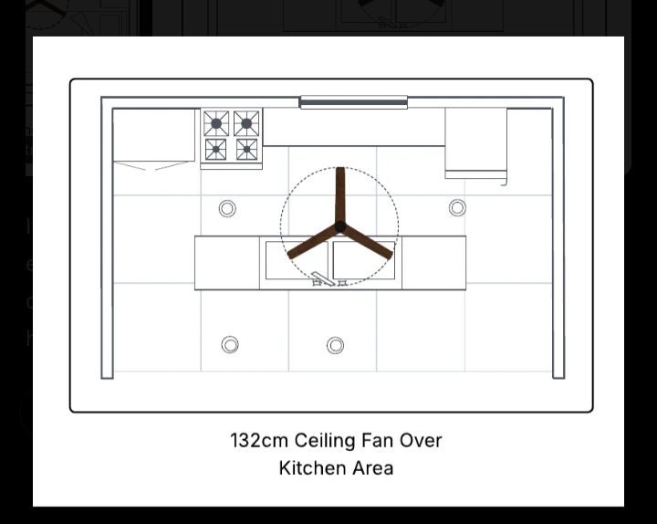

‎‎-Other Rooms: In kitchens, place away from stoves to avoid grease buildup. Attics or garages can benefit from fans for ventilation, centered high.
