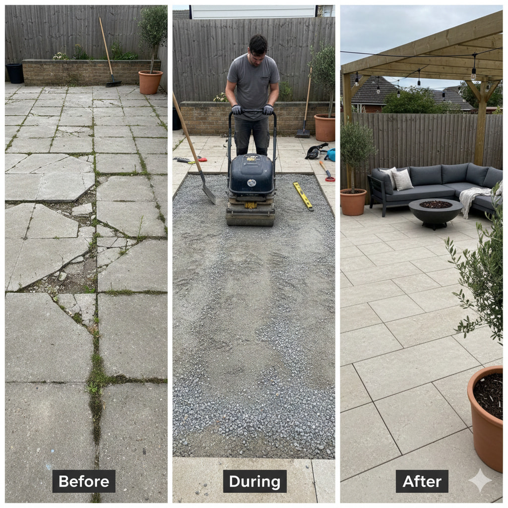

Observation:
The backyard patio was uneven, cracked, and too small for entertaining. The homeowners wanted a space that could host family dinners and weekend BBQs.
Challenge:
The soil was poorly graded, water pooled near the house after rain, and the old pavers were sinking. Simply laying new pavers without addressing the base would have caused the same problems again.
Action Taken:
Removed old pavers and leveled the ground
Added compacted gravel and sand base for stability
Installed interlocking concrete pavers with subtle color variations for aesthetic appeal
Created a slight slope away from the house to prevent water pooling
Added a small stone border and integrated planters for a finished look
Result:
Smooth, level patio perfect for seating and entertaining
Water drains properly, no future pooling
Modern, visually appealing outdoor space that increases home value
Pro Tip:
Proper base prep is more important than paver selection — skipping it leads to sinking, uneven surfaces, and costly fixes.
