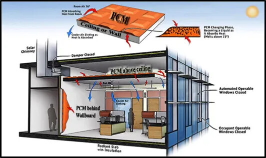

What PCMs Actually Do
Phase Change Materials absorb, store, and release heat as they switch phases (solid ↔ liquid), acting like embedded thermal batteries.
How It Works
- Too hot? PCM melts and absorbs excess heat (latent heat storage).
- Too cool? PCM solidifies and releases stored heat back into the space.
- Result: Smaller temperature swings—without electricity, pumps, or moving parts.
Why It’s a Renovation Game-Changer
- Flexible integration: Add to drywall, ceiling tiles, insulation wraps, or floor panels
- Silent & passive: No maintenance, lasts for decades
- Comfort boost: Cuts indoor temp swings by up to 7 °C (≈12 °F)
- Energy savings: ~15–30% lower heating/cooling costs in climates with big daily or seasonal swings
