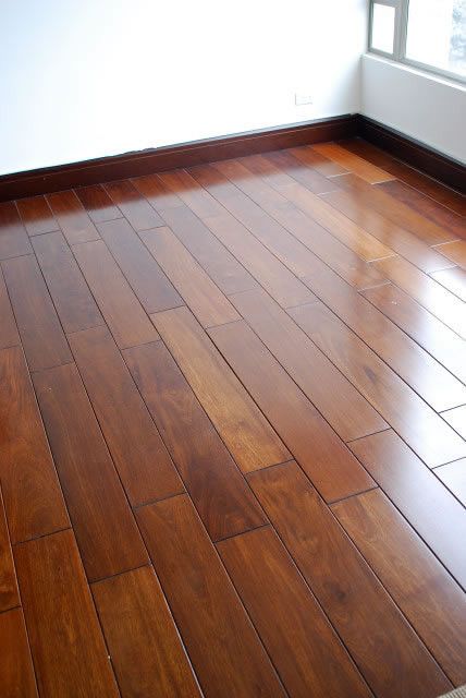

Refinishing Hardwood Floors on a Budget
Reviving dull hardwood floors is a rewarding DIY project. Rent a floor sander from a hardware store and gather sandpaper, stain, and polyurethane.
Start by clearing the room and cleaning the floor. Sand the surface to remove old finish, working with the grain. Vacuum dust thoroughly before applying stain with a brush or rag for even color. Seal with polyurethane for durability, applying thin coats and sanding lightly between them. Allow drying time to avoid stickiness.
This project takes a weekend but transforms your space, adding warmth and value. With proper care, your refinished floors will shine for years, giving your home a polished, professional look. It’s a fun activity that can be done alone or with friends and elevates your apartment appearance.
