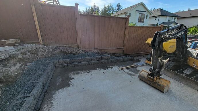

The first mistake is skipping proper base preparation. Some homeowners just start stacking blocks or stones and hope for the best. That rarely works. Without a strong base, the wall can lean, shift, or even collapse over time.
Yard before retaining wall installation — uneven soil, old slope.:backhand_index_pointing_down:

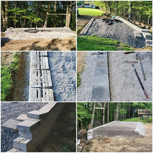

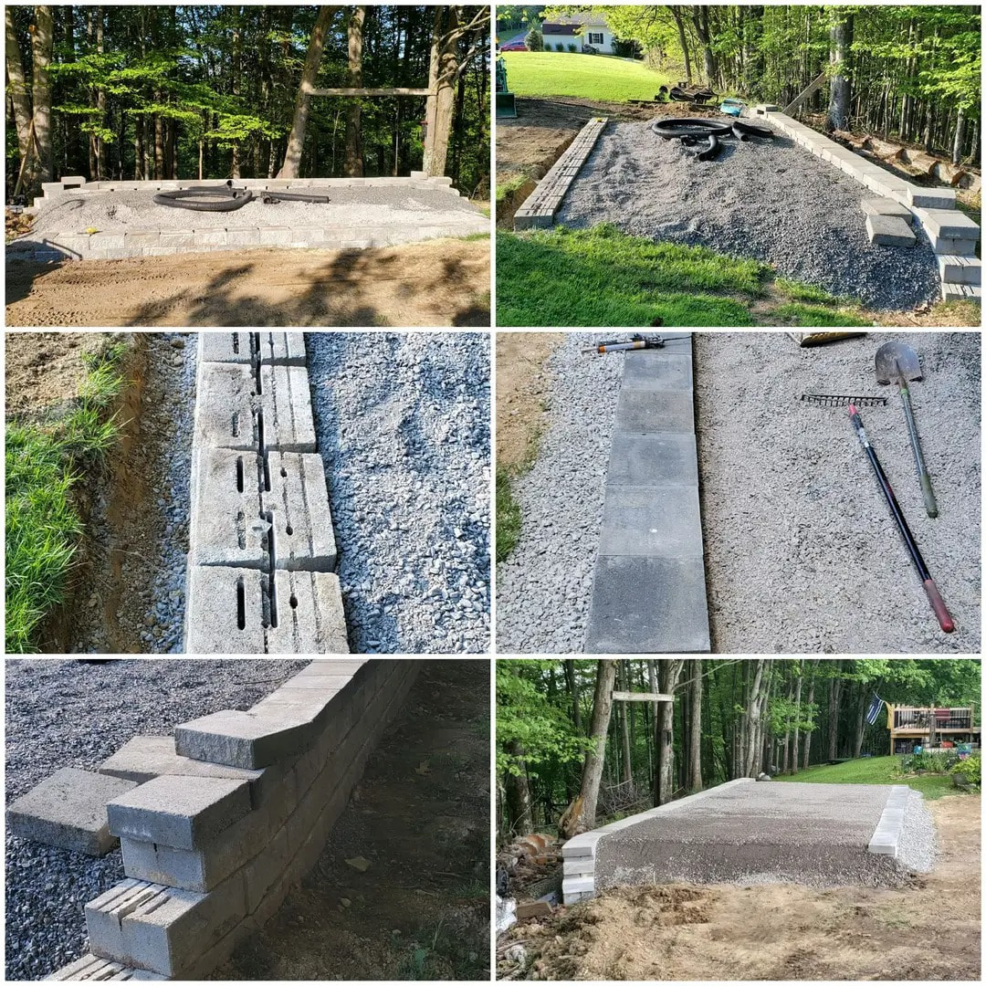

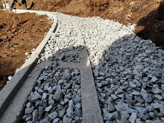

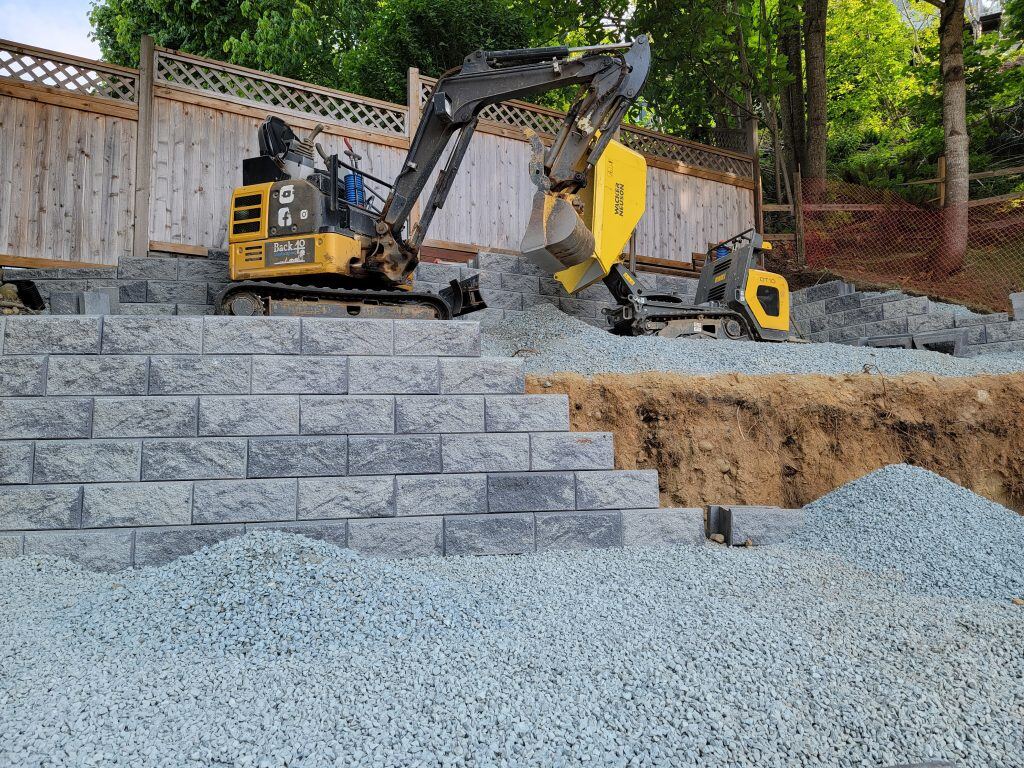

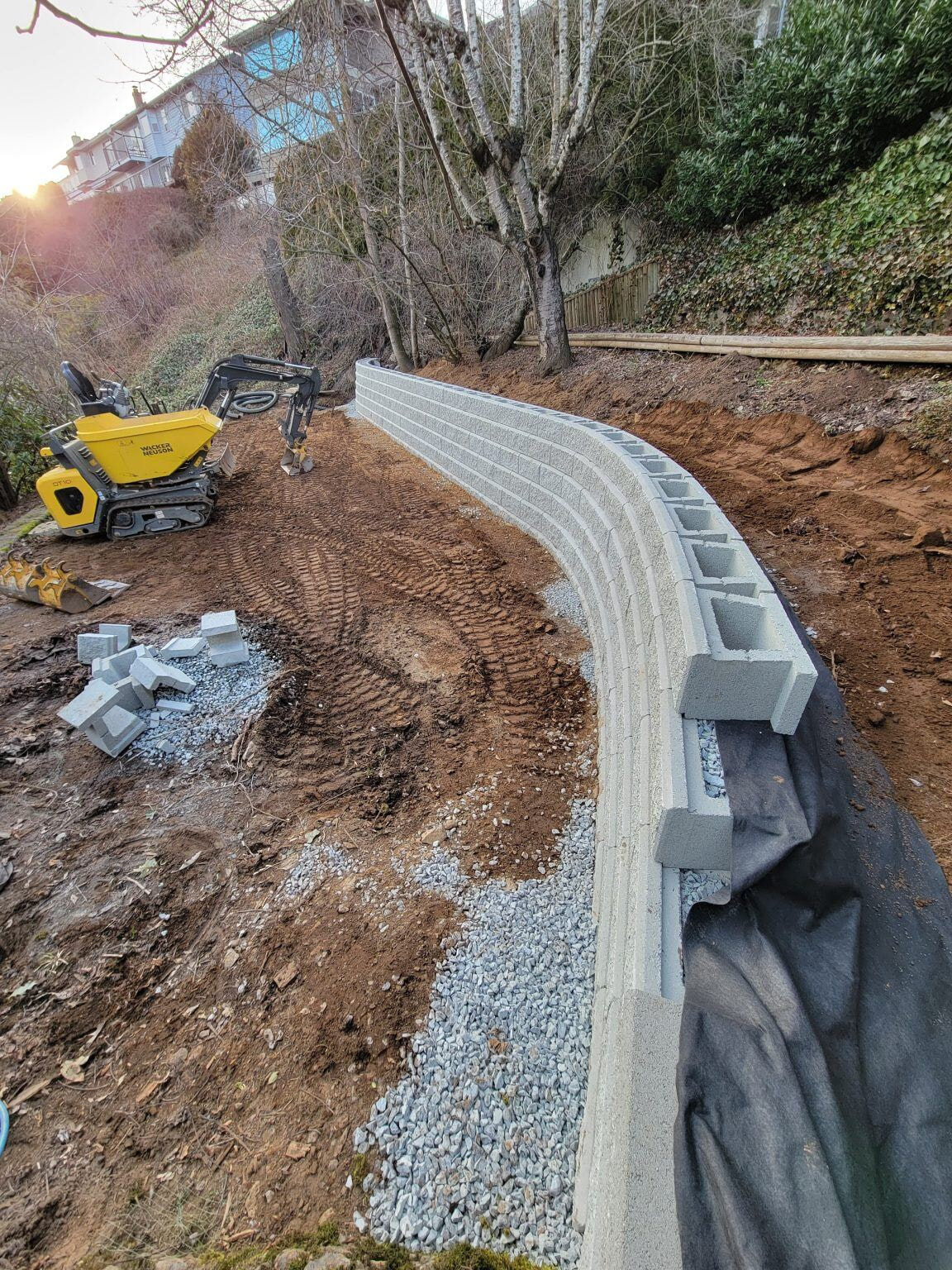

Another big issue is drainage. Water builds up behind a retaining wall and puts pressure on it. I’ve seen walls crack or bow because no one thought about water flow. Installing gravel and proper drainage pipes behind the wall makes a huge difference.
Mid-construction photo showing gravel, drainage, or blocks being stacked.:backhand_index_pointing_down:

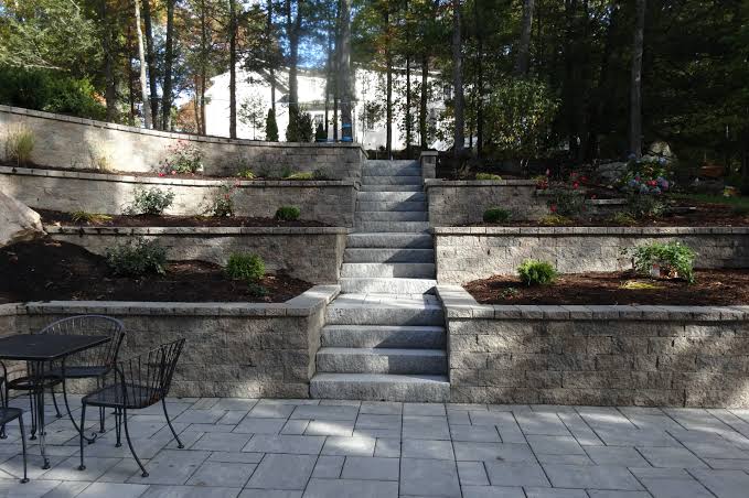

Finally, I’ve noticed people forget about slope. Even a small change in elevation can mess with the wall if it isn’t accounted for. Taking the time to measure, level, and adjust is worth it.
Finished retaining wall showing slope, stones, and landscaping.:backhand_index_pointing_down:
The takeaway? Retaining walls are more than just decorative. Take your time with the base, drainage, and material choice, and you’ll save a lot of stress later. Vancouver yards can go from messy slopes to clean, functional spaces with the right wall.
