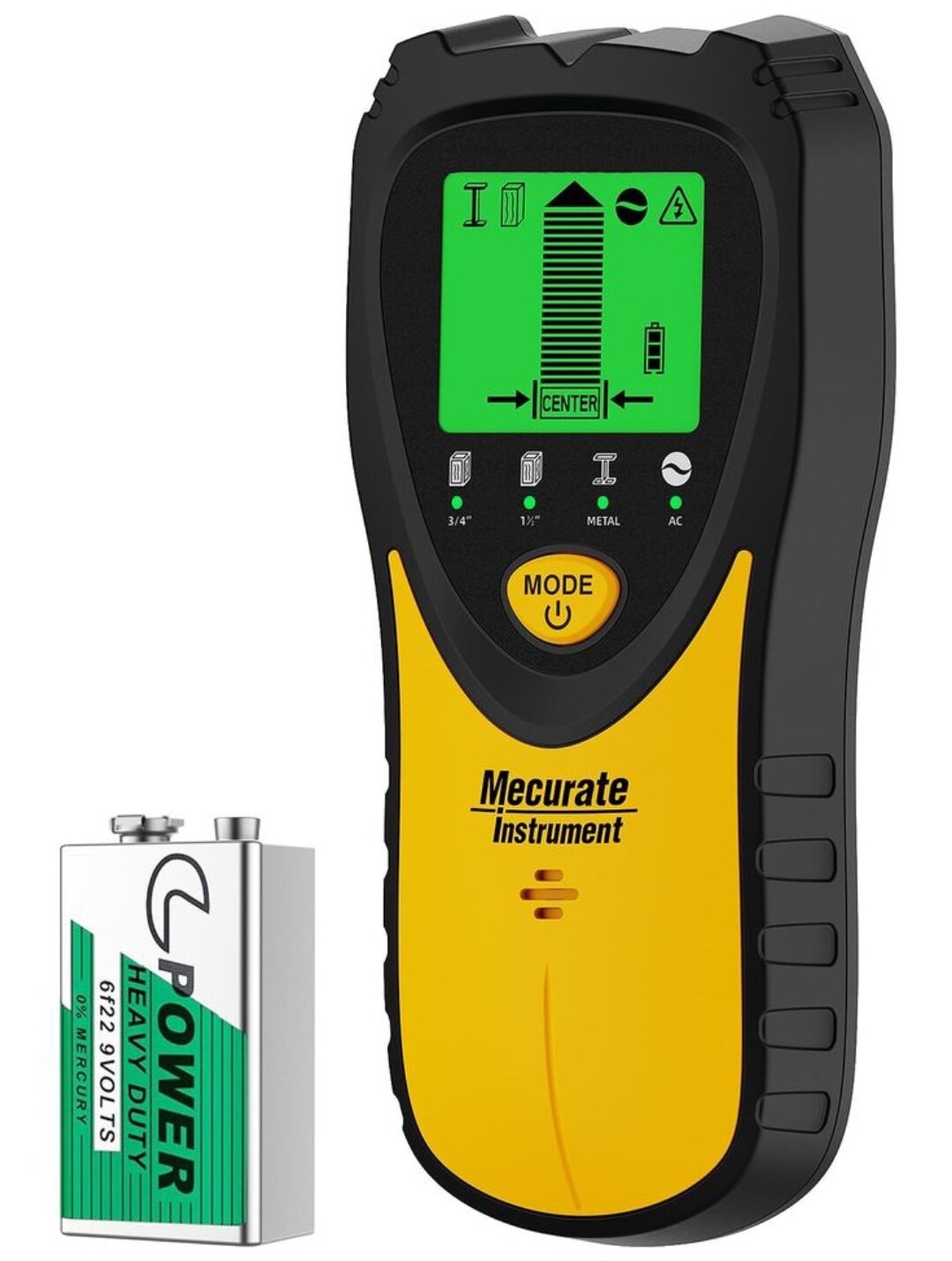

Stud Finder as a tool for Renovation
A stud finder is a simple but invaluable tool for homeowners who want to hang heavy objects such as shelves, mirrors, or flat-screen TVs safely. While it may seem unnecessary for small projects, using a stud finder ensures that nails or screws go into a solid structural support rather than just drywall, which can easily crumble under weight.
To use a stud finder, place it flat against the wall and move it slowly. Most electronic models beep or light up when they detect a stud. Mark the edges lightly with a pencil, then measure the width of the stud to find the center for precise anchoring. For larger projects, use multiple marks along the wall to verify alignment.
A quirky tip is to combine the stud finder with a small level to make sure shelves or cabinets are perfectly horizontal. This saves a lot of frustration, especially when installing a series of items along a wall. Taking this simple precaution prevents damage to walls, avoids accidents, and ensures that mounted items remain secure over time.
