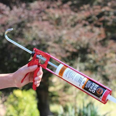

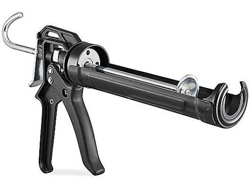

The Caulking Gun: Sealing for Strength and Finish
Sealing gaps and joints is an important part of renovation, and the caulking gun makes it possible. From waterproofing bathrooms to sealing windows for energy efficiency, this tool is essential for both function and appearance.
I first discovered the importance of a caulking gun during a window replacement project. Without proper sealing, drafts and water leaks were inevitable. Using a caulking gun allowed me to apply a smooth, consistent bead of sealant that kept the elements out while giving the window frame a neat, finished look.
Caulking guns hold cartridges of sealant and apply them evenly with controlled pressure. Manual guns are affordable and effective, while powered models reduce hand fatigue during larger jobs. Choosing the right sealant silicone for moisture-prone areas, latex for easy cleanup is equally important.
The secret to good caulking is technique. Cutting the tip of the cartridge at a 45-degree angle and moving steadily along the seam produces a smooth line. Smoothing the bead with a finger or tool ensures proper adhesion and a professional appearance.
Lesson Learned: Small finishing details have a big impact. A well-sealed joint improves durability, efficiency, and aesthetics.
Conclusion: The caulking gun is a renovation tool that blends practicality with polish. It ensures strong seals, prevents damage, and adds a clean finish to projects. Simple yet effective, it’s an indispensable part of every toolkit.
