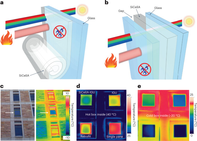

The breakthrough was published recently in Nature Energy (April 2023), highlighting that academic labs have already demonstrated transparent samples of silanized cellulose aerogel with lab scale glazing prototypes.

How It Works — At a Glance
Feature
How It’s Achieved
High transparency
Ultrafine pores smaller than visible light wavelengths → minimal scattering
Thermal insulation
Very low solid conduction due to 97% air porosity
Sustainability
Made from cellulose fibers derived from wood pulp
Light weight
Ultra light compared to glass or polycarbonate
Retrofit adaptability
-Can be cut or laminated into panel units or sandwich glazing

High performance windows: Replace poor single glazed panels in existing window frames or create light diffusing skylights while reducing heat loss or gain.
Interior partitions: Use aerogel glazing between rooms to allow daylight flow without compromising thermal zoning.
Conservatories & sunrooms: Capture daylight while keeping space temperature efficient year round.
Heritage windows: Improve energy performance without altering historical frame profiles or appearances.
