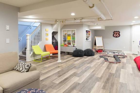

When we first bought our house, the basement was the kind of place you avoided unless you needed the breaker panel. It smelled musty, there were random cobwebs everywhere, and the floor sloped in ways that made you question the builder’s math skills. Still, I saw potential a space where the kids could play, where we could watch movies, maybe even squeeze in a small home office.
The first hurdle was moisture. I learned the hard way that painting over damp concrete doesn’t “seal it up.” It bubbles. After a chat with a contractor friend, we installed a perimeter drain and a sump pump. It wasn’t glamorous, but it changed everything. No musty smell, no mystery damp patches.
Next came insulation. Instead of stuffing fiberglass between studs (like I almost did), I went with rigid foam board against the concrete walls. It helped regulate the temperature and stopped condensation. Only after that did framing, drywall, and flooring make sense.
Choosing flooring was another surprise. Hardwood was out, carpet felt risky, so we landed on luxury vinyl plank. It clicks together easily, looks good, and shrugs off the occasional spill.
By the end, we had a bright room with recessed lights, a cozy sectional, and a corner desk for work. It felt like gaining another floor of living space without moving.
Conclusion:
A basement transformation starts with solving problems you don’t always see water, insulation, airflow. Once those are handled, design choices become easier and more fun. If you approach it in layers instead of rushing the “pretty” parts, the finished space truly feels like part of the home, not an afterthought.
