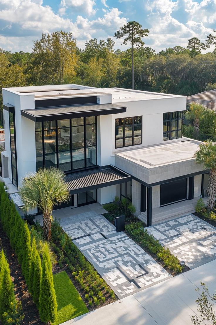

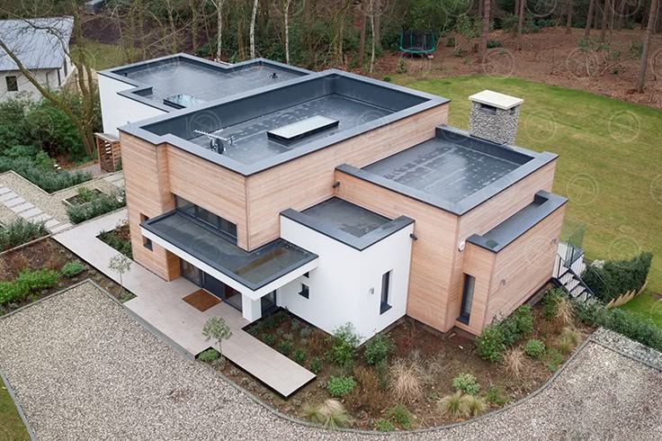

3. Flat Roof
Essentially level (with a slight pitch for drainage), this style is common in modern or commercial architecture. It’s cost-effective, allows for rooftop utilities or gardens, and is easy to install. However, it requires strong waterproofing to prevent pooling water and leaks.
- Best for: Commercial buildings, urban apartments, or minimalist homes in dry climates.

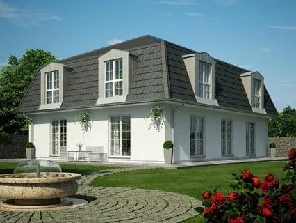

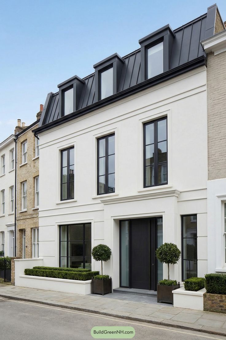

4. Mansard Roof
A French-inspired design with four steep sides (two on each half) that create extra living space in the attic. It has a flat or low-slope top section. Elegant and space-efficient, but it can be prone to snow accumulation and requires more maintenance.
- Best for: Historic or multi-story homes where additional interior space is needed.

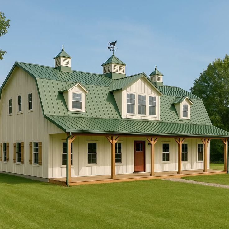

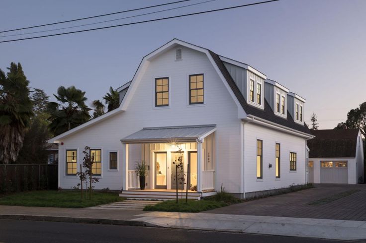

5. Gambrel Roof
Similar to a mansard but with two slopes on each side—the upper is shallow, the lower steep—often seen on barns. It maximizes attic/headroom space and has a classic look, though the steep sections can be vulnerable to wind.
- Best for: Colonial-style homes, farms, or structures needing ample storage.

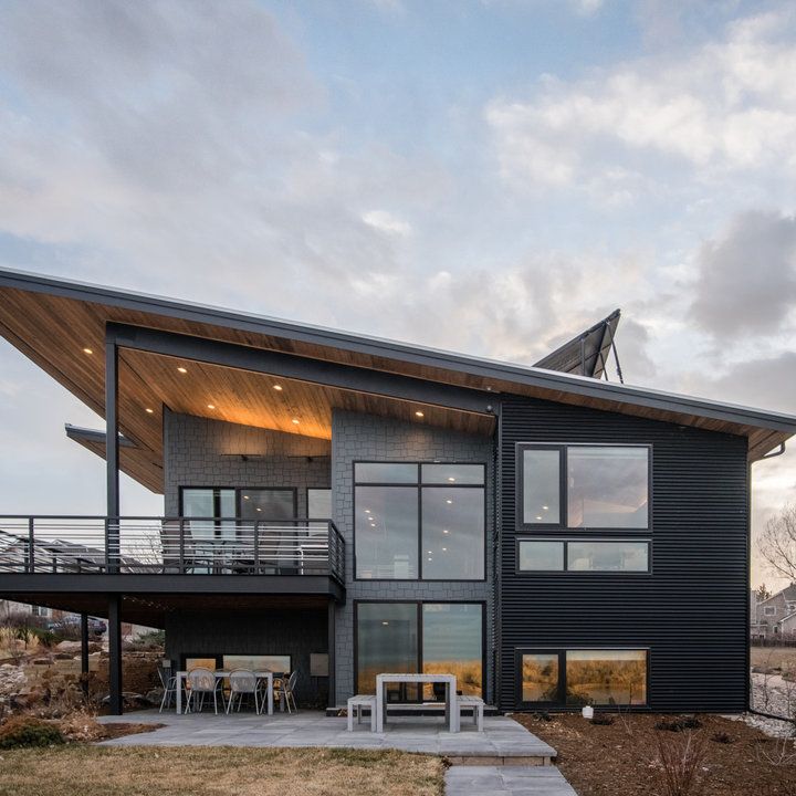

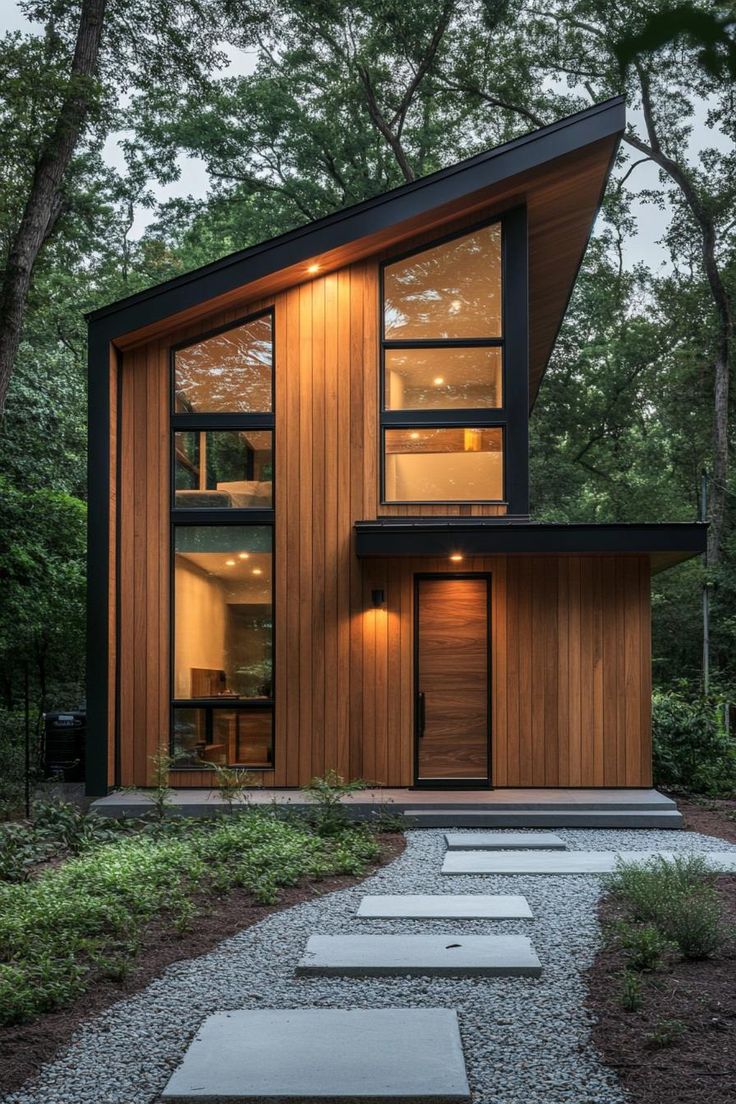

6. Shed Roof (or Skillion)
A single sloping plane, like half a gable. Simple and inexpensive to build, it allows for easy rainwater collection and modern aesthetics. It’s not ideal for heavy snow loads due to uneven weight distribution.
- Best for: Additions, porches, or contemporary eco-friendly homes.

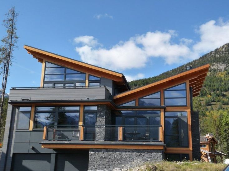

7. Butterfly Roof
Two roof sections sloping inward to a central valley, resembling butterfly wings. It promotes natural light and rainwater harvesting but can lead to drainage issues if not designed well.
- Best for: Modern or mid-century homes in arid regions.
