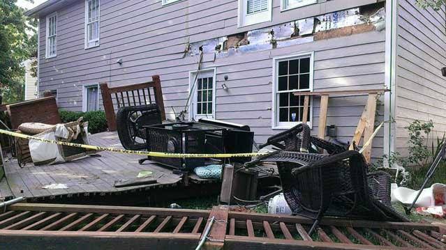

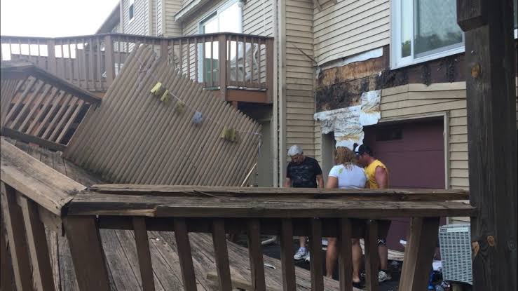

Across the United States deck collapses are a recurring renovation failure. Contractors note that many decks were built with weak ledger board connections or undersized fasteners. Over time these structures separate from the main house and collapse often during gatherings when they are heavily loaded.
The problem is especially common in older homes where decks were built without modern codes. In some cases nails were used instead of bolts. In others flashing was skipped leading to rot at the connection point. Renovators repairing these decks often find extensive water damage and unsafe framing hidden beneath the surface.
Suppliers and trade associations now promote stronger hardware systems. Galvanized bolts joist hangers and waterproof flashing are widely available. Yet renovators emphasize that installation quality matters as much as the product itself. A poorly secured deck remains a hazard regardless of materials used.
Regional climates add another challenge. In snowy states decks carry heavy loads of ice. In coastal areas salt accelerates corrosion. In humid regions untreated timber decays faster. Renovators insist that deck designs must adapt to these conditions.
Conclusion: failing decks are one of the most visible renovation fails in the United States. The trade opinion is unified that every deck must be built like a structural floor not a decorative accessory. Safety and strength come first.
