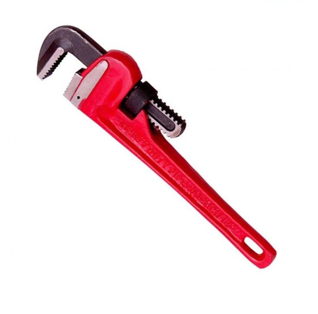

The pipe wrench is one of the most essential tools for any plumbing project, whether you’re replacing a sink, fixing a leak, or installing new pipes. Unlike a regular wrench, a pipe wrench is designed with serrated jaws that grip round surfaces firmly without slipping. This allows you to tighten or loosen threaded pipes securely, even when they are old or corroded.
To use a pipe wrench effectively, start by adjusting the jaw so it fits snugly around the pipe. Hold the handle firmly and apply steady, even pressure while turning. Avoid sudden force, as this can slip the wrench off and damage the pipe or injure your hand. For larger pipes, a longer-handled wrench gives more leverage and makes turning easier. In addition, always make sure the pipe is stable or supported before you begin, as a slipping pipe can cause accidents.
One quirky tip is to keep a small piece of rubber or cloth between the wrench and shiny pipes to prevent scratching visible metal surfaces. This is particularly useful if you’re working on decorative or exposed plumbing fixtures. With a little practice, a pipe wrench can make most plumbing repairs straightforward and even satisfying. Using this tool correctly not only ensures that joints are tight and leak-free but also prevents damage that could lead to expensive repairs.
