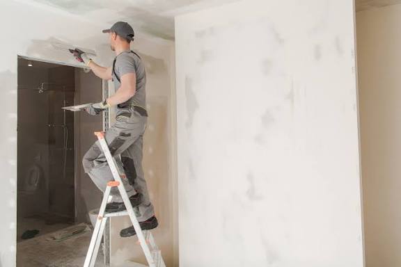

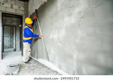

Wall finishing and plastering are important stages that improve both appearance and durability of a building. On site, plastering work begins after blockwork has properly set. The wall surface is first cleaned to remove dust and loose particles that could affect bonding.
Plaster mix is prepared in the correct ratio to ensure strength and smoothness. Application is done evenly using trowels, starting from the top and working downward. Care is taken to maintain uniform thickness and straight edges around corners and openings.
During inspection, areas with cracks, hollows, or rough patches are identified and corrected immediately. Proper curing is also ensured to prevent shrinkage cracks. Finished walls are protected from direct sunlight and heavy rain during drying.
In conclusion, good plastering work improves wall durability and appearance. Proper preparation and supervision help achieve smooth and long lasting wall finishes.
