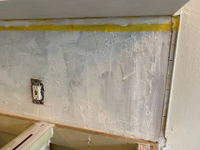

Backsplash failures often trace back to improper wall preparation rather than material defects. Trade professionals understand that wall substrates determine adhesion strength longevity and appearance. Preparation is the foundation of success.
Drywall condition must be assessed before installation. Damaged or soft drywall cannot support tile weight. Reinforcement or replacement may be required. Ignoring this causes detachment.
Moisture resistance is essential in high exposure areas. Standard drywall absorbs moisture over time. Moisture resistant boards reduce failure risk. Material choice must match conditions.
Surface flatness affects tile alignment. Uneven walls cause lippage and inconsistent grout lines. Flattening compounds correct irregularities. Precision improves finish quality.
Priming improves adhesive bonding. Dust porous surfaces and contaminants reduce adhesion. Proper primers create consistent bonding surfaces. Skipping primer shortens lifespan.
Backer boards provide superior support in heavy tile applications. Cement boards resist moisture and movement. They add cost but increase reliability. Trade professionals use them strategically.
Fastener placement affects stability. Improper spacing causes flexing. Flex leads to cracking. Manufacturer guidelines matter.
Waterproofing membranes protect walls behind backsplashes. Even small leaks cause long term damage. Membranes add protection without altering appearance.
Penetrations must be sealed correctly. Outlet boxes and plumbing points are failure zones. Proper sealing prevents moisture intrusion. Attention to detail prevents damage.
Substrate transitions require planning. Different materials expand differently. Without transition management cracks form. Expansion gaps protect systems.
Timing matters. Substrates must cure before tile installation. Rushing leads to bond failure. Patience prevents callbacks.
Trade sequencing affects outcomes. Substrate work must be completed before cabinetry and finishes. Poor sequencing increases rework. Order matters.
Quality control checks catch issues early. Straight edges moisture meters and visual inspection reveal problems. Early correction saves money.
Documentation protects accountability. Recording substrate preparation ensures standards were followed. Transparency builds trust.
Training matters. Skilled trades understand substrate behavior. Experience prevents mistakes. Knowledge protects results.
Conclusion: Proper wall substrate preparation is essential for backsplash success. Trade discipline in preparation prevents failures and extends installation lifespan.
