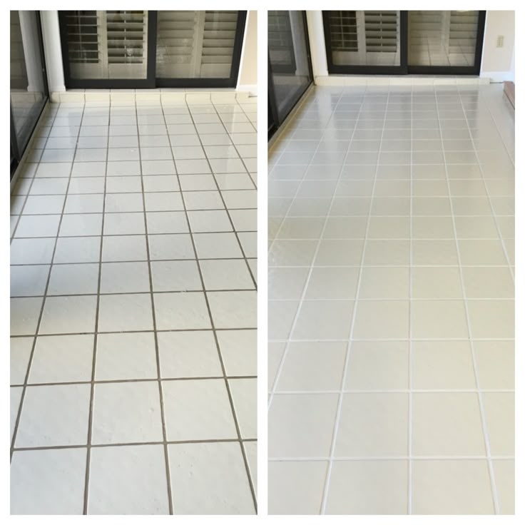

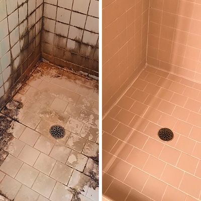

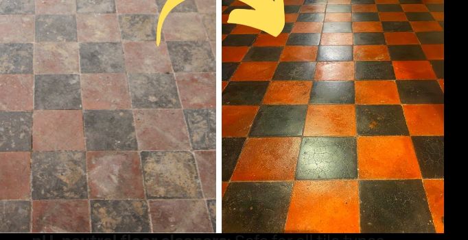

‎These before and after examples illustrate the transformation possible with proper cleaning:
